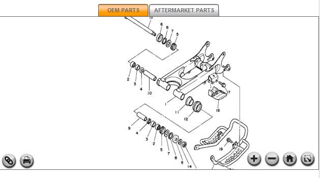

I bought a +4 swing arm off of ebay and installed it onto the machine. When I took it up north I notice the it would sway back and forth. I had to crank the sh*t out of the main bolt before it held. I pulled the main bolt off and pulled out the swing arm. The roller bearing cage is much larger then the main bolt. What do ppl do the shim it?

wait, upon further thought, see if the inner races will pull out of your old swinger's bearings, maybe they don't supply them
yes, if they did not supply the washers, caps, swinger chain roller, then i don't believe they supply the 2 bushings, parts 9 & 10 in this bikebandit.com schematic............
you'll need to pull them from your old swinger, clean, grease and reinstall into this swinger
yep, you have to use everything off the stock swingarm except the bearings.
