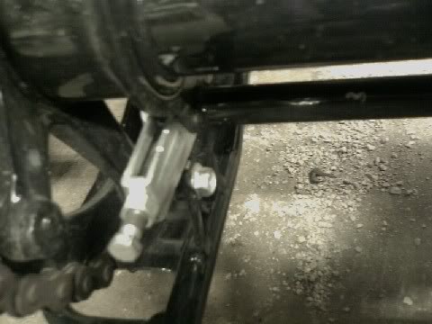

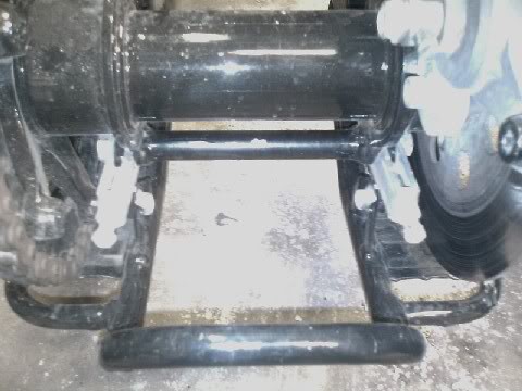

01blasterdude New Member Jun 2, 2008 391 6 18 Bradshaw, Nebraska www.wolfesmetalfabrication.com Jul 22, 2008 #5 Sure...BRB....with a pic
01blasterdude New Member Jun 2, 2008 391 6 18 Bradshaw, Nebraska www.wolfesmetalfabrication.com Jul 22, 2008 #6 You can see in the one picture the notches on the top of the adjusters (silver adjusters) Loosen the lock nut, and then tighten the bolt to tighten the chain, then retighten the locknuts. You can use the notches, and the bolt lengths as a reference to make sure you are getting them evenly.
