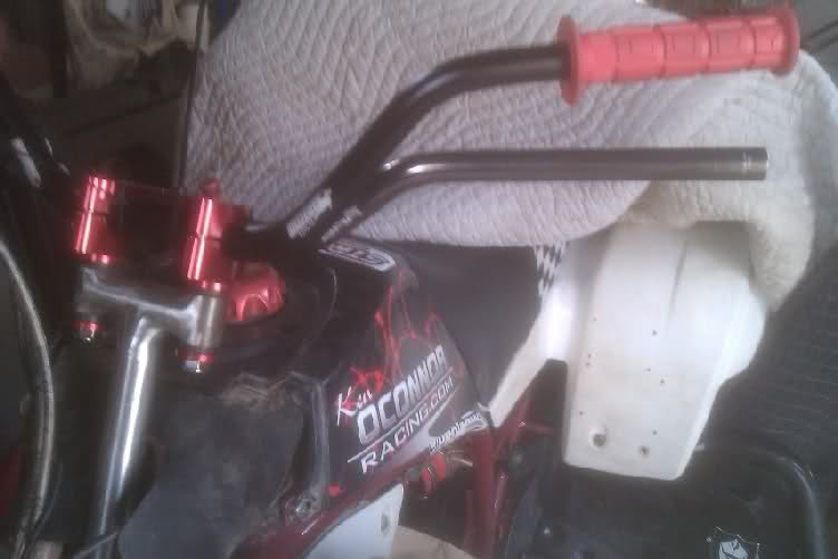

Joe, do you care to elaborate on this part of your sig a little bit? AWK's extended anti-vibe stem. How does one freate an "anti vibe" stem?
here's the 2 i made for speedy and his pap, they wanted stock length as they were running flex bars that already sit high......
in the thread linked below is mine, it's a plus 2" chrome moly stem with an east coast atv anti vibe clamp and ended up with 1-1/8" trail tech x bars
(scroll down for the stems, i got sidetracked with other parts for a while :) )
http://www.blasterforum.com/dress-up-parts-148/mmmmmmm-billet-44903/
mine came out so nice i polished it and hit it with a clear coat
