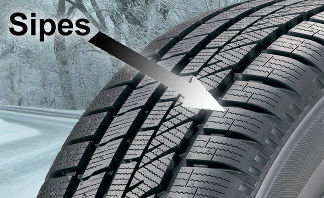

I don't know anything about ice racing, but if I was to tackle it I would look for the softest rubber compound I could find, I would cut the tread blocks with as many razor cuts (sipes) as I could in a chevron pattern, like this:
The reason they are wavy is to lock under stress, you don't need that, just lots of cuts.
And lastly, treating the rubber with bleach just before a race might help.
