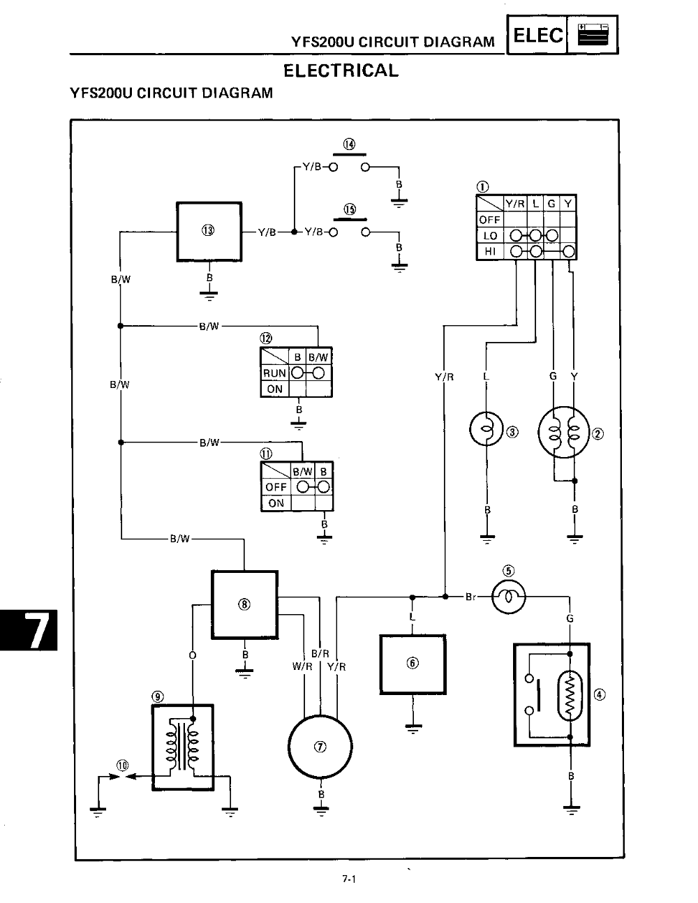

The two black wires going to the left hand kill switch are the correct wires. Lets look at this another way.... Maybe your stock switch was fine but there was a short or cut in the wires. It could be that something moved around when you hooked up the new switch.
Go to your CDI box (under the front hood/headlight area) and unplug the Black with White stripe wire from the CDI itself. If the B/W wire is grounded it will cut spark. Disconnecting it will pretty much hotwire the quad to start without a key or kill switch. It also cuts out the yamaha tors system. Do not disconnect the solid black wire to the CDI. That is the CDI's ground. If your blaster starts then you have a short someplace in your B/W wire. I attached the diagram below.
8=CDI
11= key
12=kill switch
13= TORS control unit.

Nice info with the diagram, I love how simple the blaster is.. I'm use to looking through pages and pages of diagrams on a car ha-ha ..

Did you try unplugging that black-white wire from the CDI though? There is no direct connection between the coil and kill switch. Its all via the CDI. So you would really need to cross some wires up to mess with the coil.... but anything can happen if the harness was messed with before.
on the cdi there is a black one grounded to the bolt on it and a blue wire comin out of it
