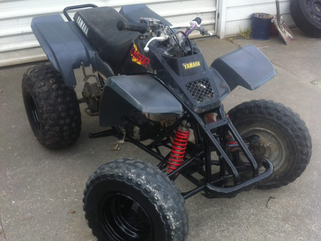

Picked up a 1996 Yamaha blaster other day cheap as and I kind of knew some thing was wrong with it as it had just about little to no compression and kick starter wouldn't spring back.
It has. FMF gold series exhaust on it. oil injector tank removed and lines to side of engine removed. Haven't had a look if oil pump still in there.

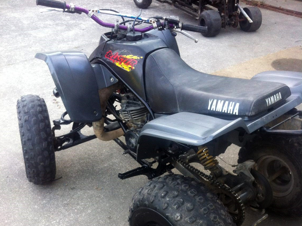

Here is the quad.

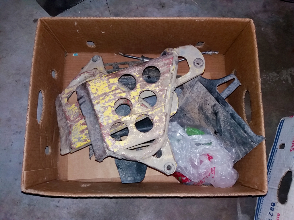

Come with stock heal guards and plastics.

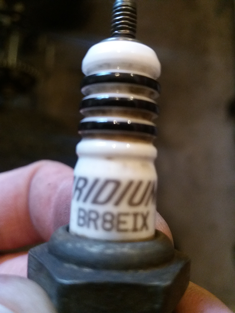

Spark plug they had in it.

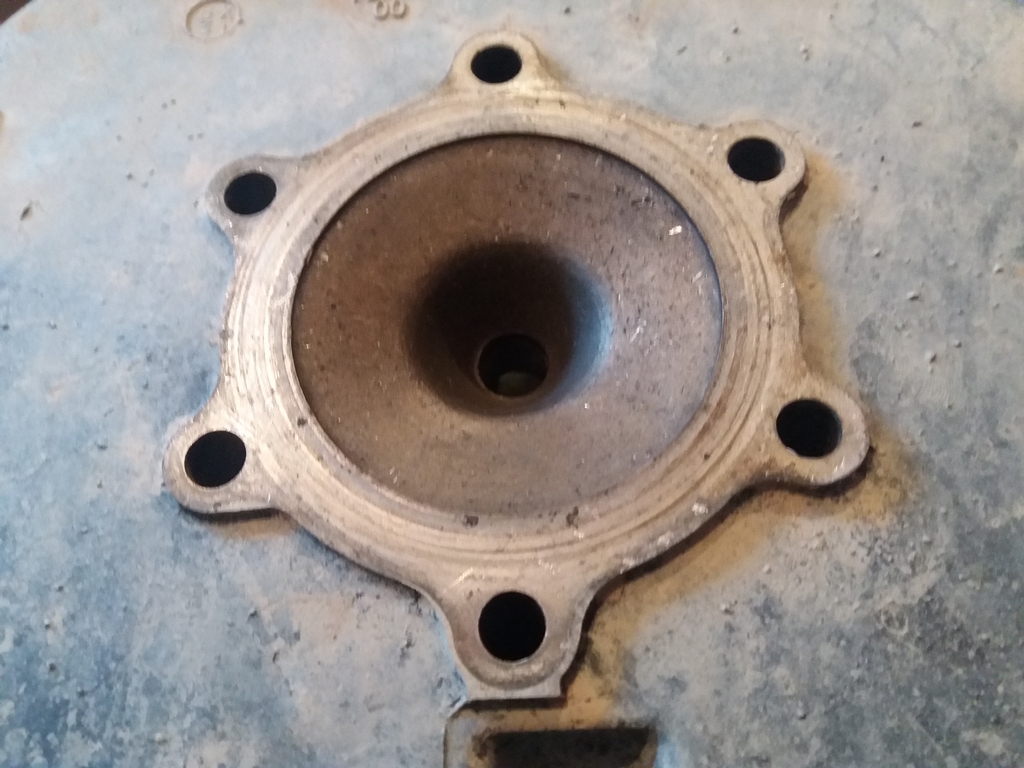

The head looks fine.

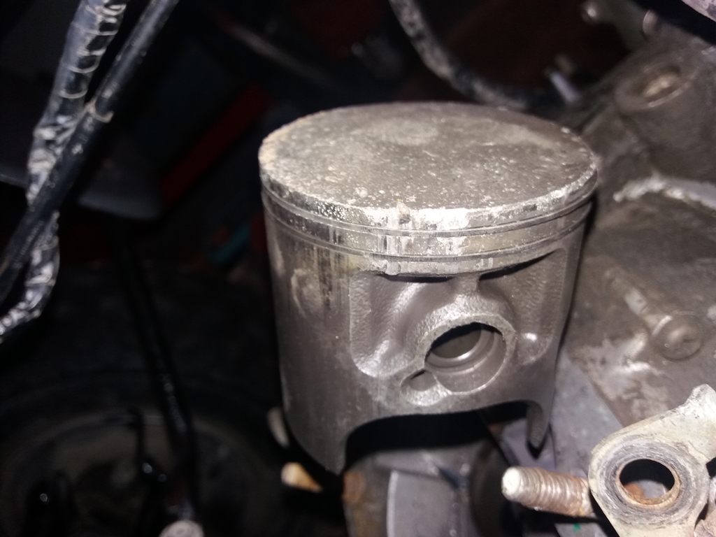

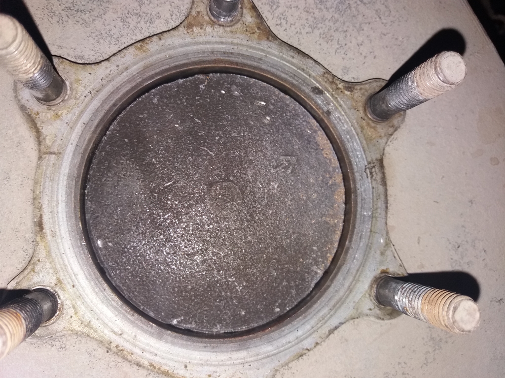

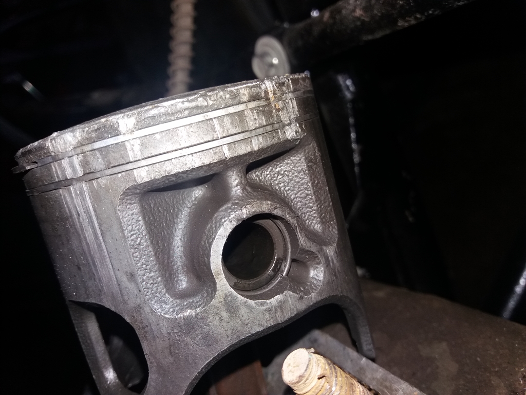

Piston no so good.
Remove cylinder and oh hello metal bits. :eek:
Piston had a hard time put still in one bit.

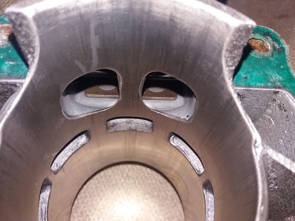

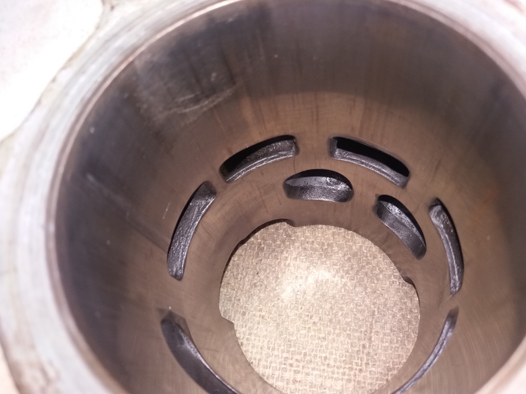

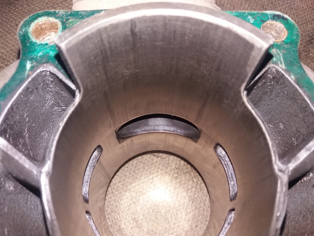

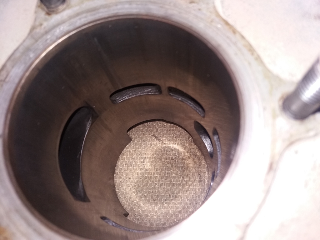

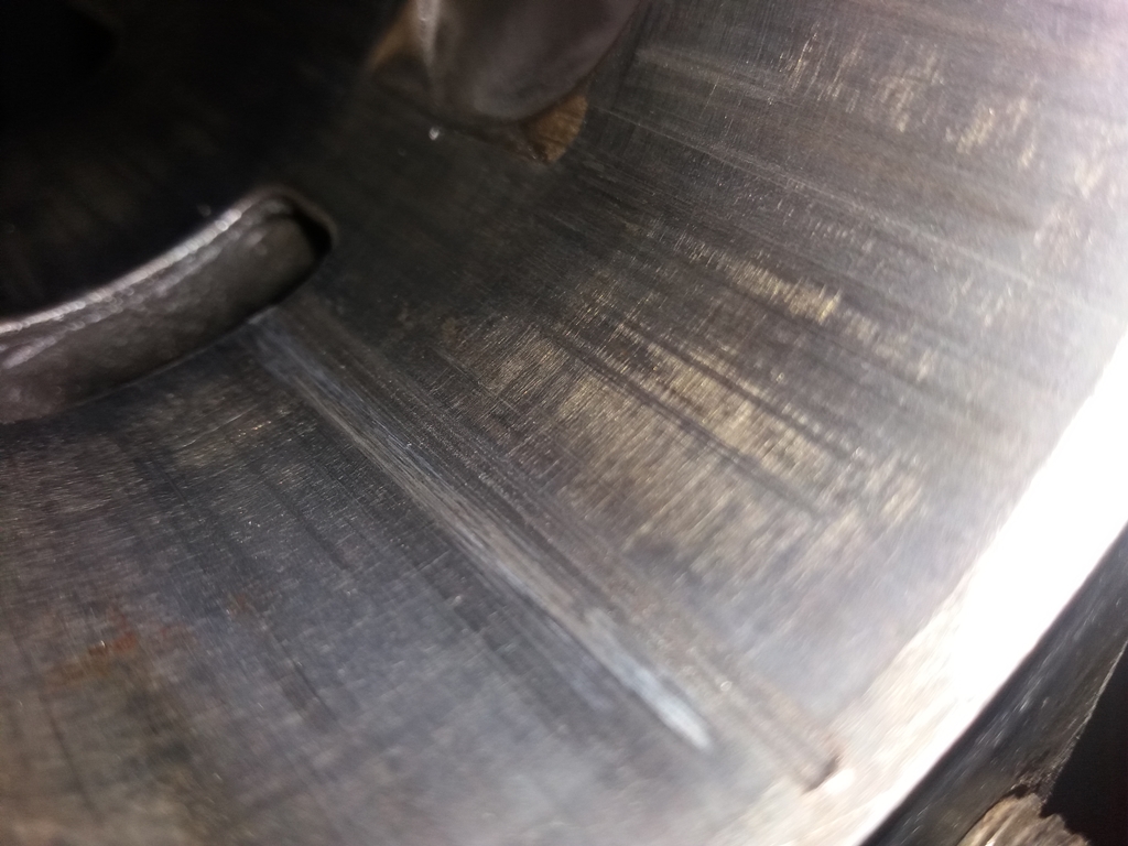

The bore looks ok. Guess it could be bored out.

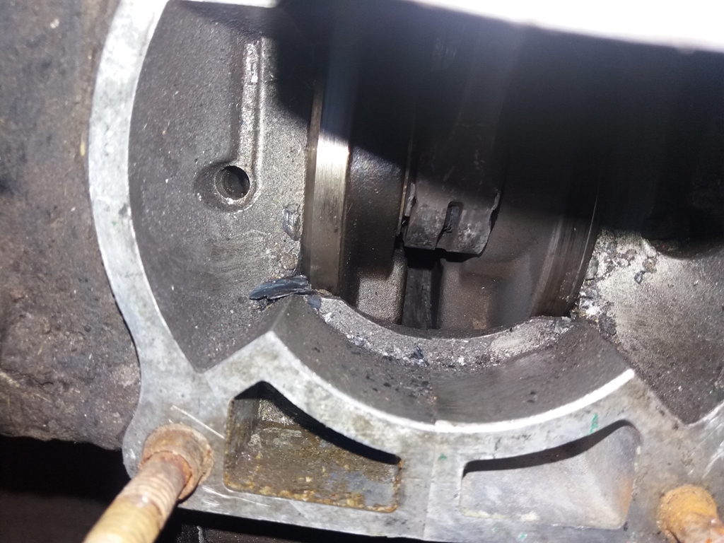

This is the worse part.
I didn't clean the greasy / dirty engine because I knew it was most likely toast after doing compression test on it and got nothing.
So how did it happen. They forgot to install the rubber cap on the carburetor for the oil injector. That's what I'm guess has cooked this engine. Or they forgot to put 2 stroke oil in the fuel.
Check this out. Look at the color of the connecting rod. :eek::eek::eek::eek::eek::eek:

Also the back brake don't work. Front wheels have been flipped. Engine kill switch was not connected. Air filter was not installed but in box.

If you look at the crank picture, you'll notice no thrust bearing on the right and not much left of the left one. That little thin piece sitting there is whats left of one.
Any hobby costs money :D
