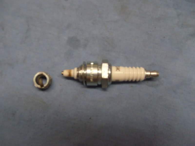

there is a very fine line way of doing this to tune your motor in perfect.
start your bike, warm it up and ride down the street with a plug socket and a brand new plug in your pocket, stop, pull the used plug out, put the new one in, (now heres where people mess this process up) start it up and go 1st through atleast 5th WOT and when you hit 5th full blastyz cut the motor off and pull in the clutch, roll to a stop and take the plug out. now what you want to do is put the plug in a vise and cut the threads down almost to the bottom like the picture shows. the picture is my trail blasters plug chop at full throttle, it is perfect cant get any better than this, you want a nice and clean plug (not wet or black obv.) the strap should look like mine (almost no color very faint brown) and the light brown ring should be around the electrode, remember 1 pull thats it! its the only way your going to get dialed in perfect and be able to ride "worry free"

i don't cut the threads, i use a good flashlight and a magnifying glass to veiw the smoke ring.
but if you'd like to waste a plug, use a hacksaw and vise to hold the plug while you cut
