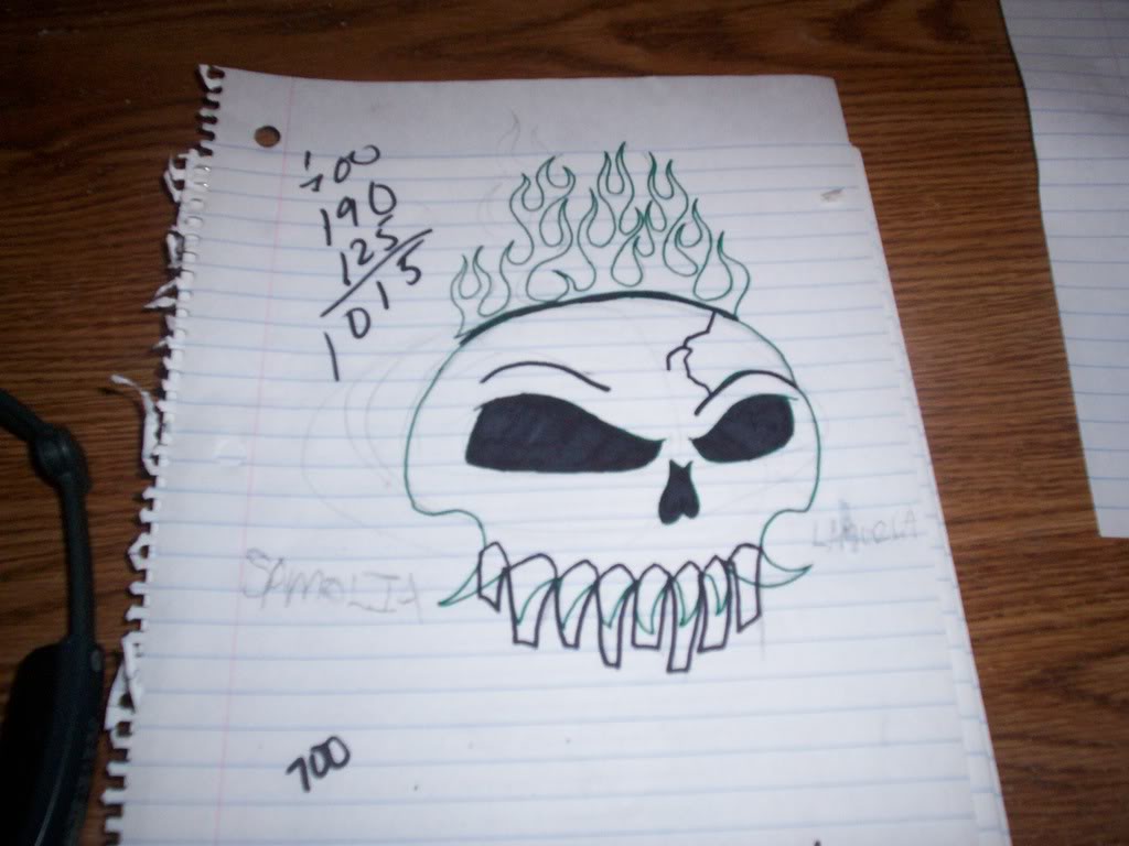

STEP ONE: draw a picture of what you want obviously i drew a skull but you can put whatever you want.
heres what i drew.

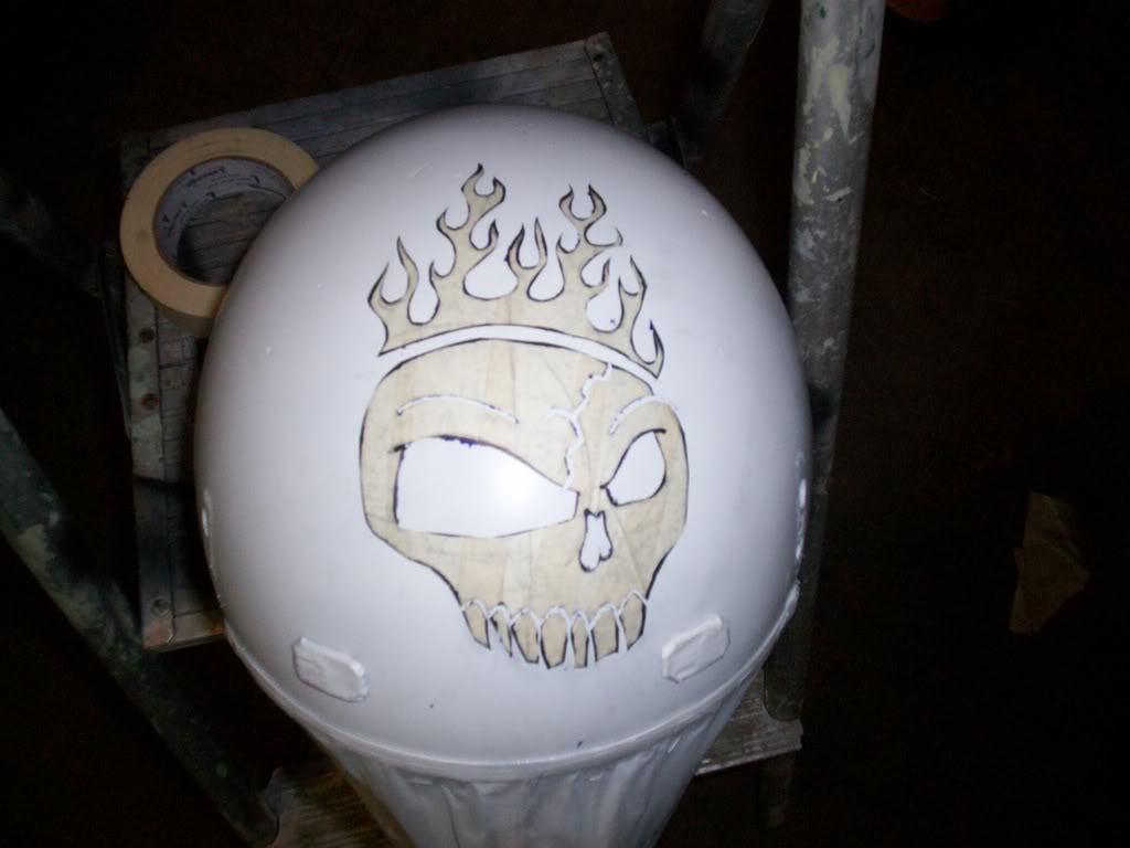

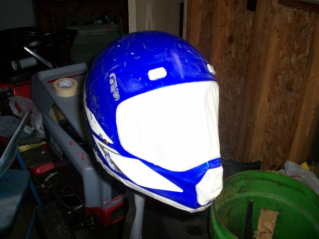

STEP TWO: mask off the helmet your paint job is only as good as your masking job i know this part isnt very fun but you gatta do it good to have a good outcome.
so by this point your helmet should look like this.

first i laid out the white for the skull then i started masking off the top off the helmet but with each peice of tape i stuck it on my pants first so it wasnt as sticky so it wont take the paint off.
then you start sketching the design on the helmet as you can see i did in this pic
STEP FOUR: time for cutting.
when you get done sketching you have to use a razor blade to cut the tape in a neat line so it will turn out good.
now this part can get confusing all the parts you want black you have to cut out and all the parts you want white you have to leave the tape as you can see i did in the pic

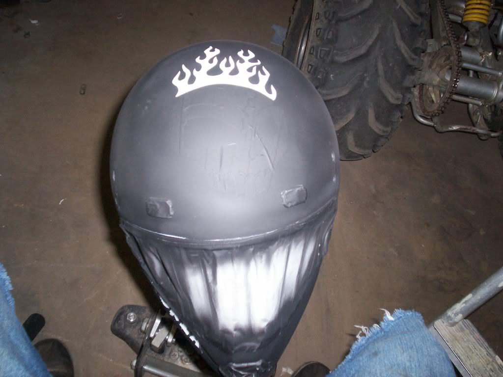

STEP FIVE: start applying the last color of paint now if you want the the lines to show up nice and crisp then i suggest not painting anymore then 3 coats.
after you paint it then you can start removing the masking tape as you can see in the pic

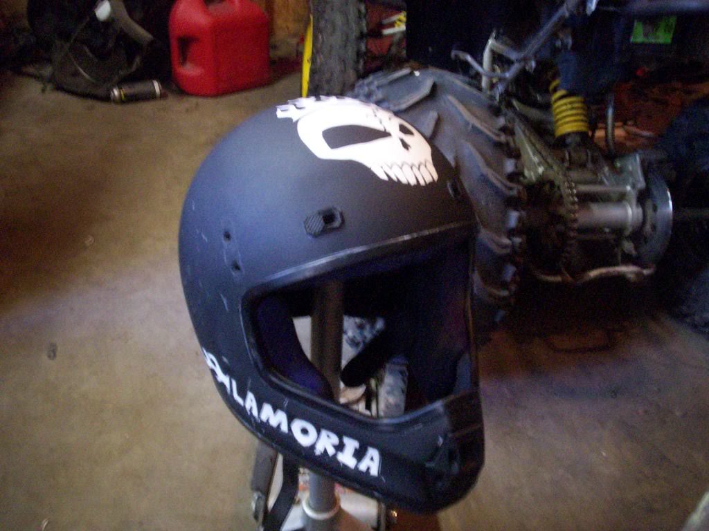

STEP SIX: normally this step would be saved for clear coating but since i want mine flat black i skipped this step.
STEP SEVEN: step back and enjoy the work you have done!!!!!
