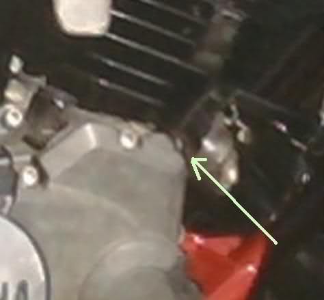

for the kicker side front one, i cut off the "water pump outlet tube", and re-installed the plug, even though it doesn't penetrate the case, that made getting at that one much much easier
no close up pics of it now, i can get some, but just cut it half way down, as i said, it doesnt even go into the case, it's plugged with casting, like it would need drilled out for the dt motor water pump set up
makes that front nut as easy as the rest
best i could find right now from my recent build thread, it's cut off so low, you can barely see the rubber plug stickin up in this pic.........................
