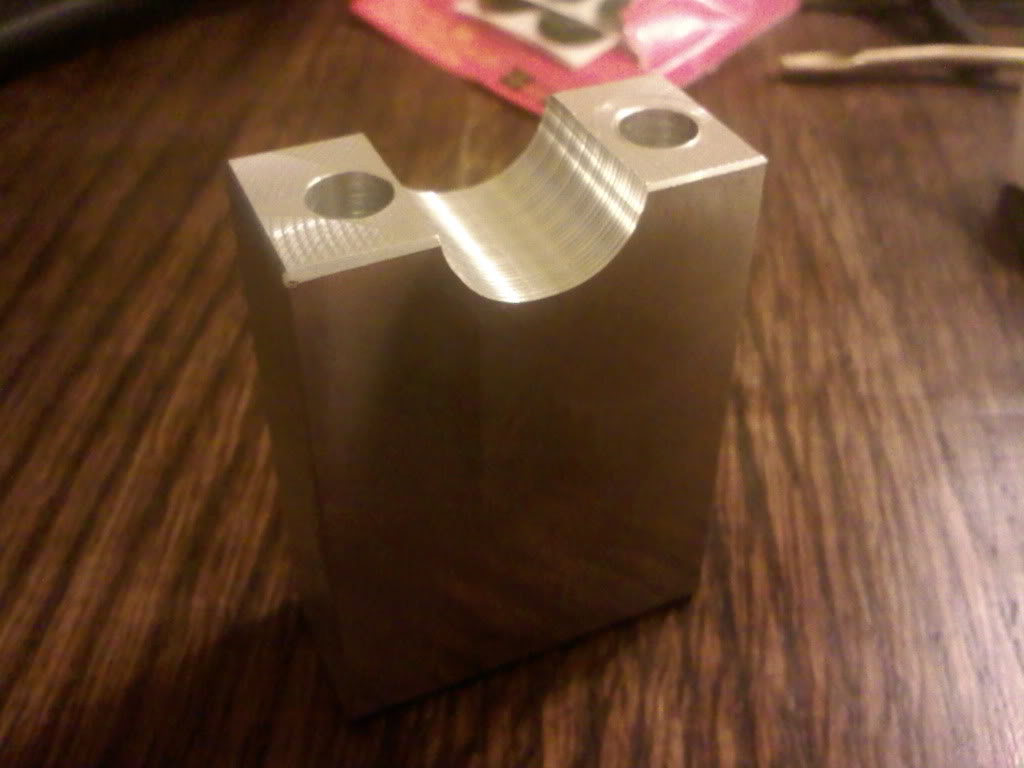

going to make spacers for my blaster's handlebar, any ideas how i can going without binding cables/wires?

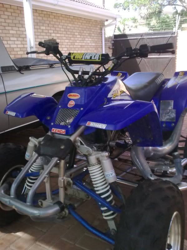

i believe +1 and +1 1/2 have been done, but doubting + 3 will work without at least moving the cable splitter up, the bottoms seem to have enuf play to allow more for the top, if i remember correctly since going hydro on both blasty's
i have 1" raisers and i have no problem. im hearing anything over 2" wouldnt be good for raisers bc tere would be too much pressure on the bolts. unless u get a shee stem or mod the stock stem. theres a DIY on how to cut the bar and add a tubing with a little welding

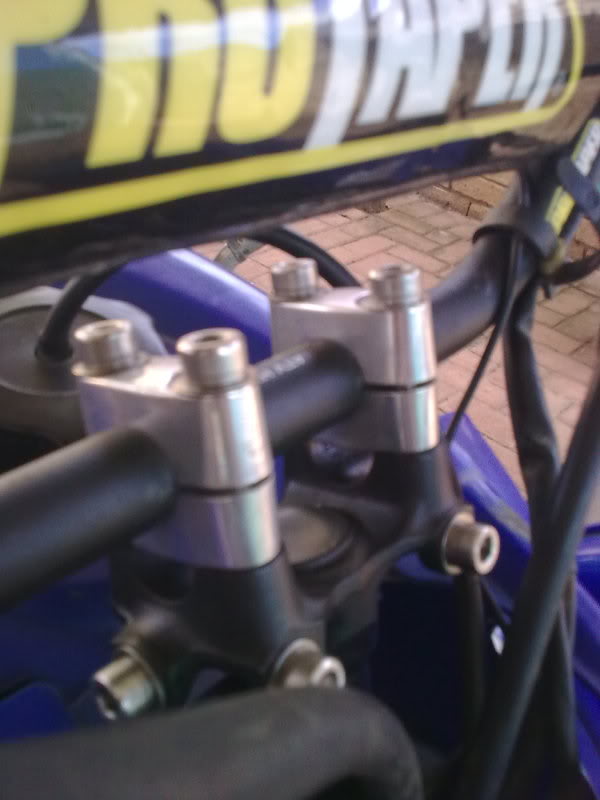

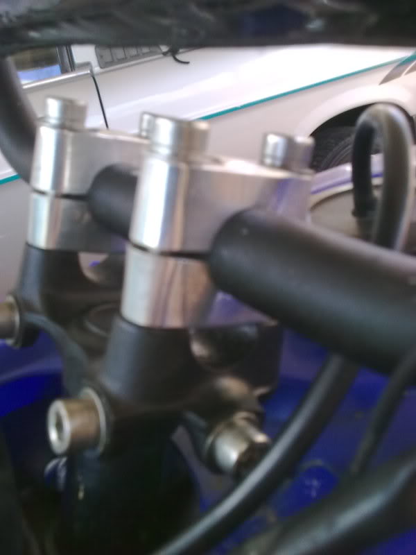

i used another set of standard bar clamps, turned then upside down, put another set over the top and used longer bolts, also have the hi rise bars, much better! clamps give about 1" i polished the clamps up on a buffing wheel.
remember, the angle the steering column sits at...the higher you go, the closer you bring the bars towards you. so three inch will leave u sitting with with your elbows stabbing you into the guts when you turn

raising the bars isnt gonna increase ur turnings but itll give u better control of the bike depending on the rider. most taller guys do this mod. u can wheelie easier and when u stand while riding u really have better height with the bars so gives u better comfort. less fatigue at the end of a ride. its huge difference u should try it. get sum used handle bar clamps and stick them in there. need longer bolts tho. theres a DIY on it

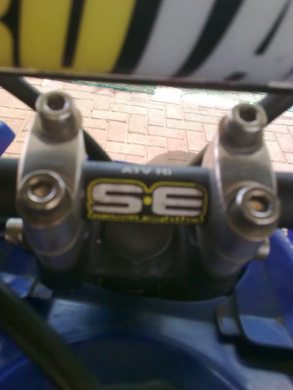

did you take into account that the top clamps are not symmetrical? rather they have one side that is thicker than the other, they should only be fitted one way
