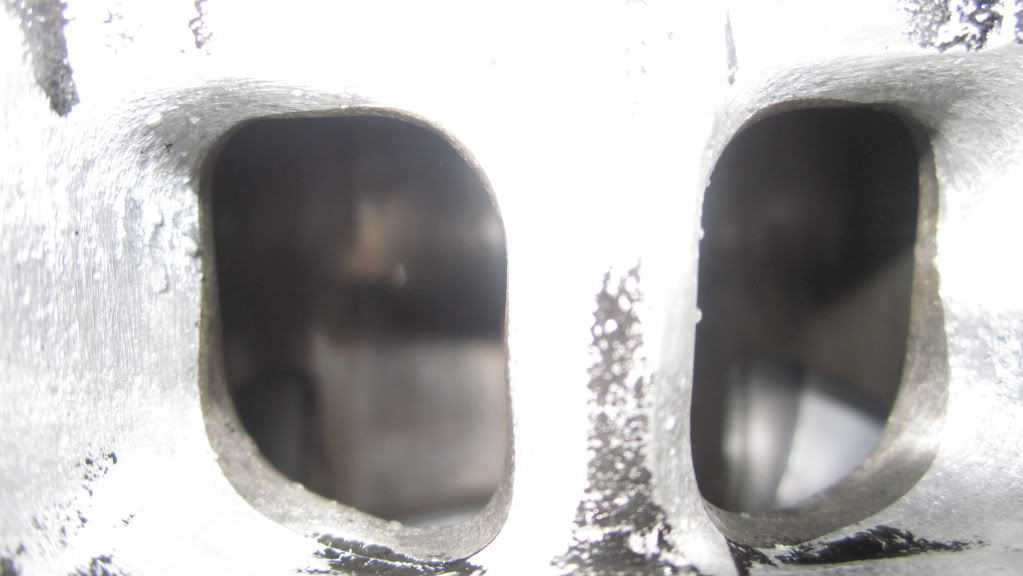

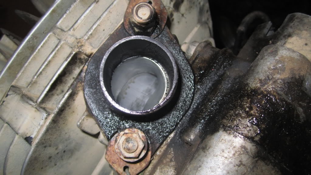

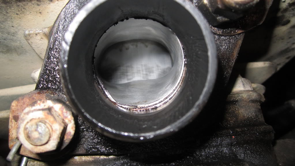

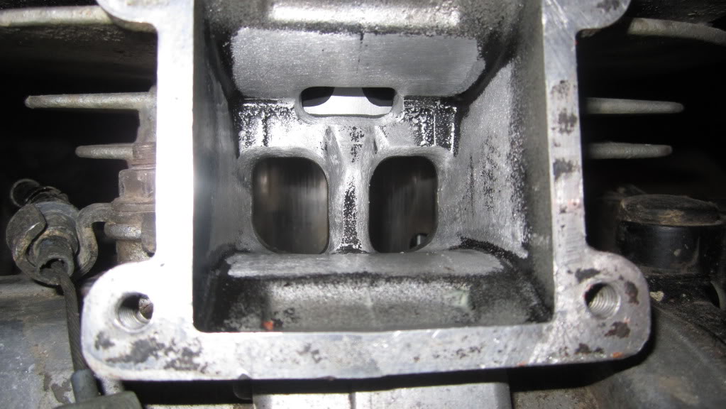

Not much can be gleaned from the "look" of it. It's more about the port timing and area than how routed out the intake is.
But, just from looking at it, I'd have to guess it's a relatively mild port job.
Now, get a picture from the top (with the head off) and stick a degree wheel on the flywheel and that'll be a much better indication of how aggressive the port job is.
