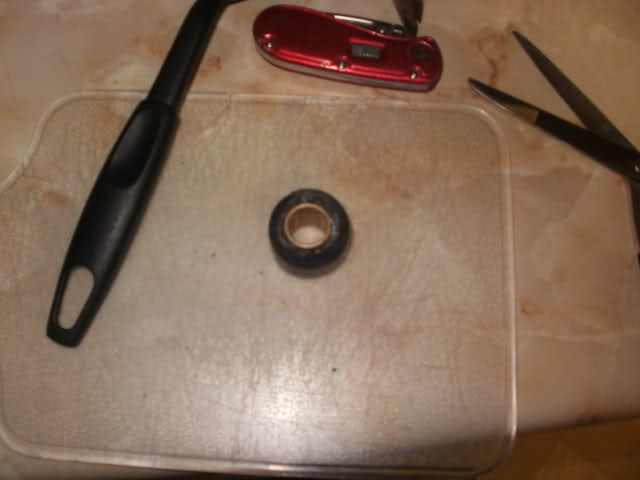

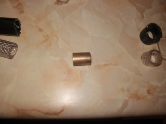

This is a 5/8" x 1 1/8" Bronze Bushing Sleeve. I removed the remains of my old roller/tensioner from the stud and put this sleeve on and
tightened the the bolt & washer back down to make sure it would spin freely. It did. If it binds at all you will have to shave it on a grinder.
I took it back off and stuck it in the freezer. I got this size because that is all the harware store had. Sicivicdude reccomended a 1/2".
That will probably work better because mine was a little big, but still works well. If you go with the smaller bushing sleeve you will have to
adjust your hose sizes accordingly.

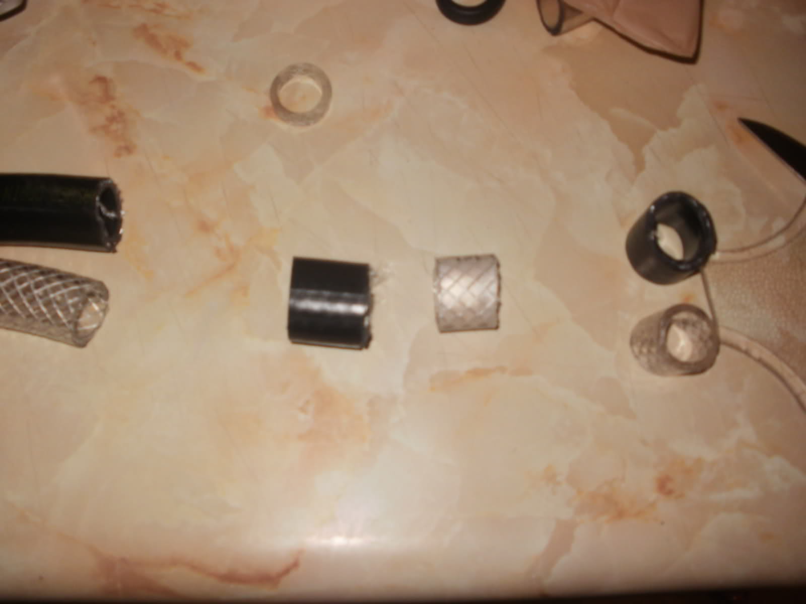

I cut the hoses as close as I could to the sleeve length. Make sure not to be any longer than the sleeve with your hose length.
This could cause the roller to bind. These two hoses will not fit inside of each other without some work.
But after the extra effort you get a tight bond that will not seperate. Put the smaller hose (3/4") in the freezer at least 30min
and the bigger one (7/8") into boiling water(the diswasher hose is good to use here because it is built to hold high temps).
After one is cold and the other hot stretch the hot one over the froze one and force the smaller one in.
Be careful the bigger hose is really hot when it comes out of the water. But just suck it up and put it on because it goes on easier
the hotter it is. After that pull the bronze sleeve out of the freezer and hammer it into the two hoses.
Now you have a chain tensioner. The hardware store usually charges by the foot for hose so go ahead and get the whole foot
so you will have plenty left over for next the next few times you have to do this. Just take the bushing sleeve off and put new hose on it.
I think I got about $5.00 bucks in this and will probably get about 7-8 rollers out of it. It is definently the way to go.
