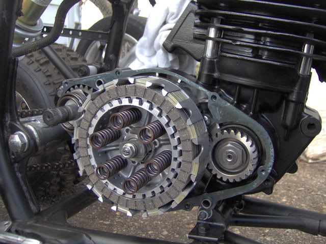

I just replaced my crank seal and got everything back together started it up and I have no clutch. The lever is very limp. I can put it in gear and it wont move. Any ideas? Im lost I put everything back together the way I took it out.
Sometimes when you bolt on your pressure plate, the clutch rod gets uncentered in the slot behind the pressure plate. This causes the clutch to feel like it's not grabbing. Pull the clutch cover and take off your pressure plate and make sure you line up the arrows on your pressure plate before you bolt it down. The piece I'm referring to can be seen in the center of the clutch in the picture below.
Yea i just changed my seals and had the same problem.I had to take the clutch cover back off cuz i didnt have the mark on the presure plate lined up so it didnt go in all the way.
