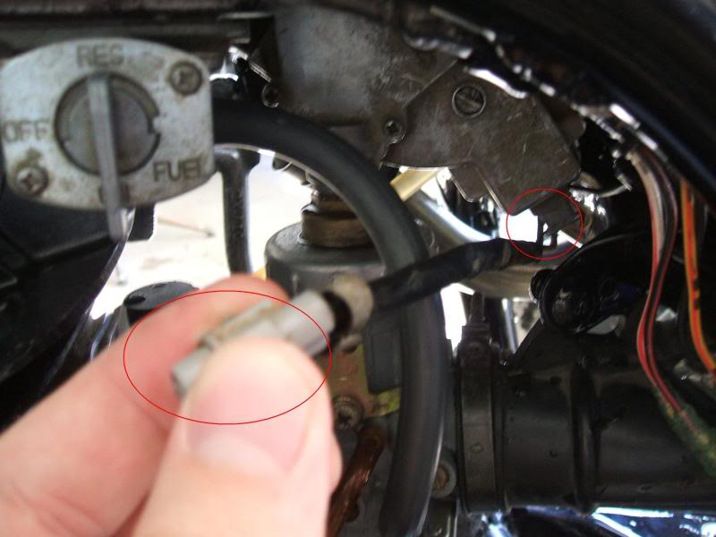

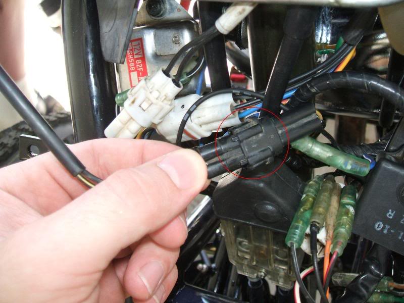

1. Remove your front plastic and unplug the TORS "brain". It is circled in red
2. This wire comes off of your carb and is part of your TORS. Disconnect it or cut it off at the carb, or both.
3. Next either cut this wire or take the 3 screw out of the top of the throttle box and take the switch out of the middle. Its only 4 screws so it should be easier to figure out. Once again circled in red
4. Disconnect the other end of the wire you just disconnected in picture 3.

1. Unplug the wires from the carb box to the harness. (It sounds like you might have done this already, hence the prob)
2. Unplug the throttle switch (connection is under the hood)
3. Cut the plug off your throttle switch, leaving about two inches (from the plug).
4. Connect the two wires together (solder, wirenut, tape, you choose) and plug the connector back in.
5. As for the E-brake switch, follow it down from the clutch handle and unplug that too.
Thats, really all there is to it. You can remove the TORS box and/or the ebrake as you want. The important thing is to not let them F--- with you.
