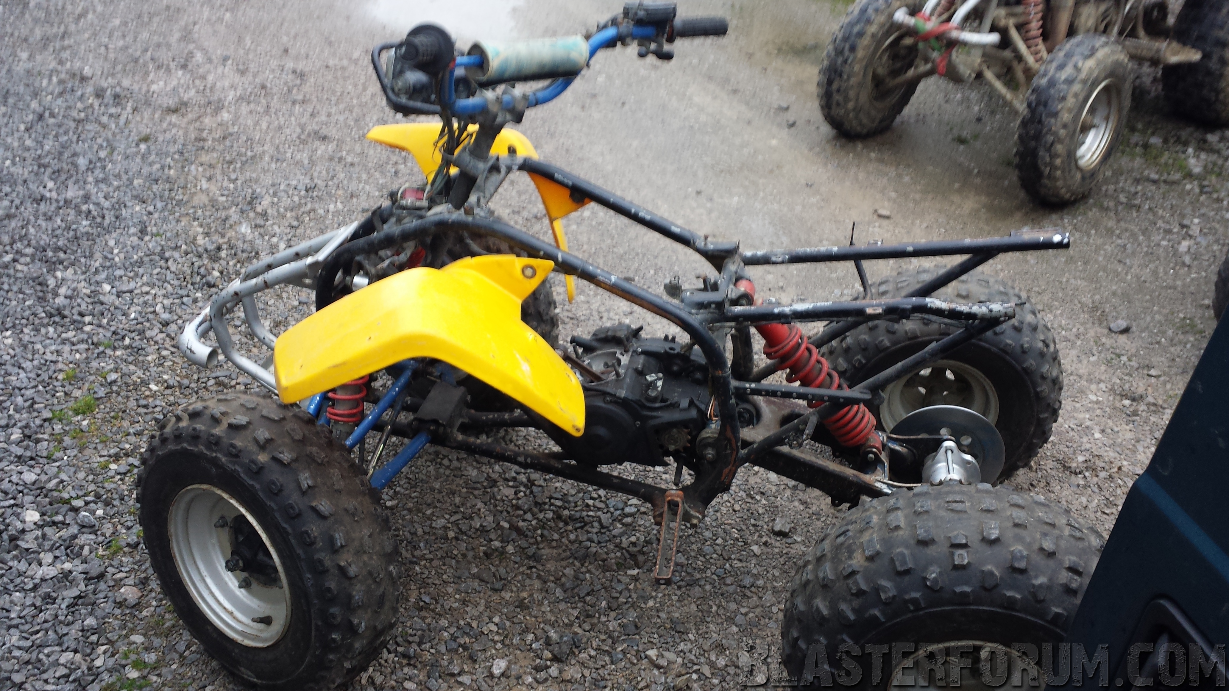

It looks like I may have a sickness because I just bought another blaster. It's a pre 2003 and when I was talking to the guy I thought I might have been able to fix it for a reasonable price. But it's clearly a parts bike. It's OK I needed a couple things for my other blaster and for $100 I couldn't pass it up.

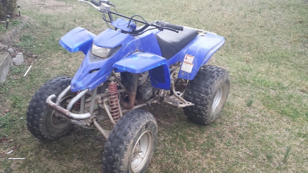

Finally got a chance to wrench on the blaster and get some pictures. She's still dirty but it's alot better than before. Got a new clutch lever, clutch cable, brake lever, oiled uni filter and some grips installed. I have a tors delete kit and a oil injection delete kit on the way and I already got some front fenders to install. Eventually I would like to get a aftermarket pipe on it preferably fmf and get a spare jug off to ken oconnor racing to be bored and honed Maybe even ported. It currently has a cheap ebay top end on it and I'm honestly afraid to run it. As soon as I get my next pay check in it'll be off to ken. Should I get the head shaved a little? I would like to keep it on pump gas but wouldn't mind a lititle more power while I already have it apart. This will be a trail machine when I'm done so I don't need anything to radical. Any opnion on what way to go? I'm holding out on the leak down test untill I get a good top end on it.

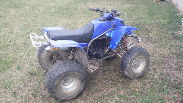

I was off the last two days and made some pretty good progress on the blaster. I deleted the tors and added the vitos kit to it. While I was at it I got the carb apart And did a thorough cleaning. I'm glad I did a jet was partial blocked and the emulsion tube had a few ports blocked. I also pulled the side cover and put a oil pump block off plate in. Put in fresh trans oil. Put a new set of bars on because the old ones were bent. I put on a PRM grab bar because it didn't have a grab bar when I bought it. Drained the fuel tank and filled it with fresh premix (32:1). Installed new boyesen reeds and a boyesen reed cage that came with my parts blaster. Sealed the leaky exhaust and put a good silencer on. The old silencer was broke in 3 places and held on with hose clamps. I removed all the oil injection parts and caped the carb. I also recovered the seat the foam was in rough shape and it came out a little lumpy but its fine for a rider.
It started second kick and idled great not erratic like before. I go to take off and proceed to fog out my neighborhood with burning trans oil. I can't do anything but laugh at my misfortune at this point. I'll order some crank seals and go through that mess on my next day off if I have the time. Here are some pictures of the blaster sporting some new parts. Funny enough it ran great other than all the white smoke. When I drained the oil it was very thin and smelled of gas so I'm thinking the previous owner knew of the problem and band-aided it to get rid of it. But all is good she will be a good runner after I spend a couple hundred more dollars.
