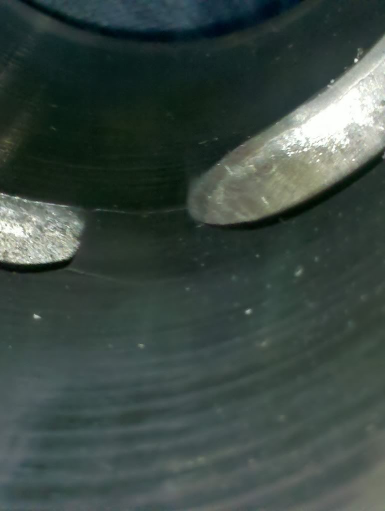

so came to a a halt. for a bit well cylinder will be here tommorow. and went to my uncles 2day and and looked at my old cyl and heres what i seen.:(
