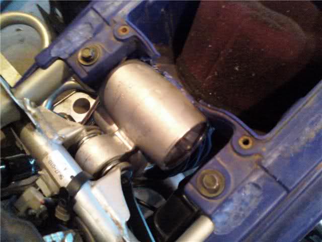

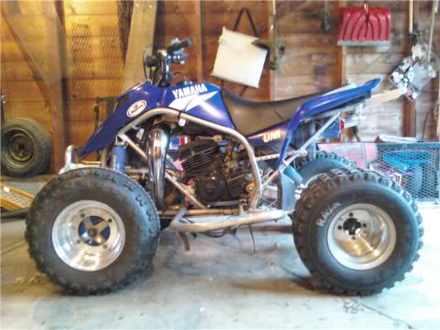

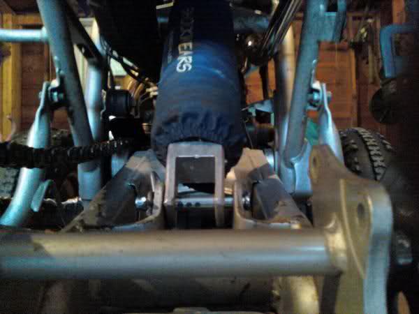

top mount was tuff
well took the blasty out to the pit and the 400 ex shock was a big improvment....well worth the 25 bucks i got in to it.
this does confirm, i thought i was gettin a 400 ex shock for $45 off e-bay, but knew this wasnt one cause the resivour is offset to one side, wrote them a email, it ended up being a '05 trx450r shock, i had to cut the metal tab from the frame that the plastics mount too to get it on,a few washers, brass bushings and new top bolt, drill the bottom shock mount to fit stock pin, but i didnt cut my airbox, it rubs a little, and heated my snorkel to bend it to clear resi,
rides like a dream
