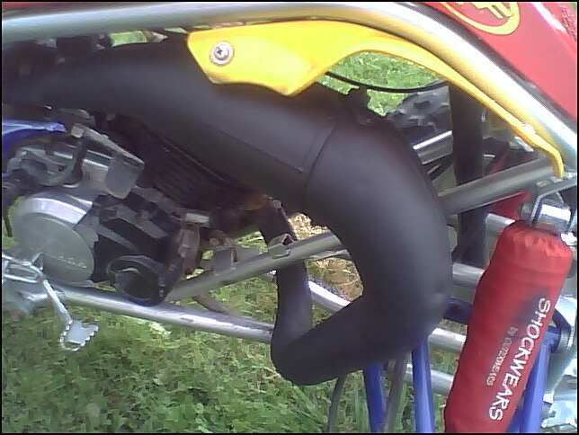

this is my LRD pipe. the whole kit i think is $350 not exactly sure though. It seems to be good for top end, not much low end from my experience so far.
Mid-top is more what Im looking for. I'll be mostly riding it on wide open trails and dirt roads, not too much tight stuff for it right now. That lrd pipe looks good too yodaman. Didnt they change the design of those pipes or something?
