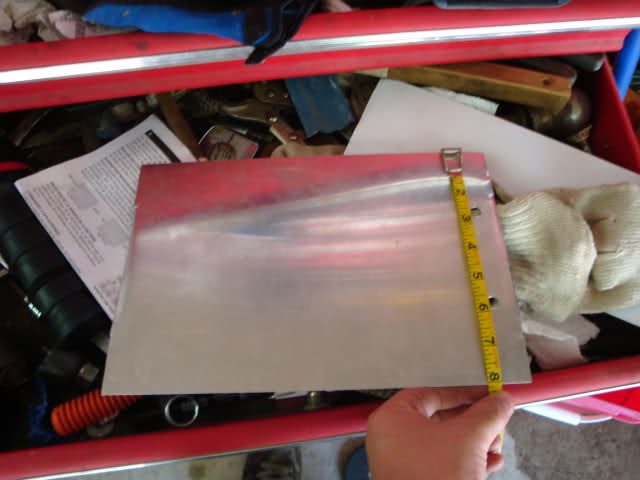

1. The sheet of aluminum I used was 12x8. You can get this at home depot or other hardware stores.

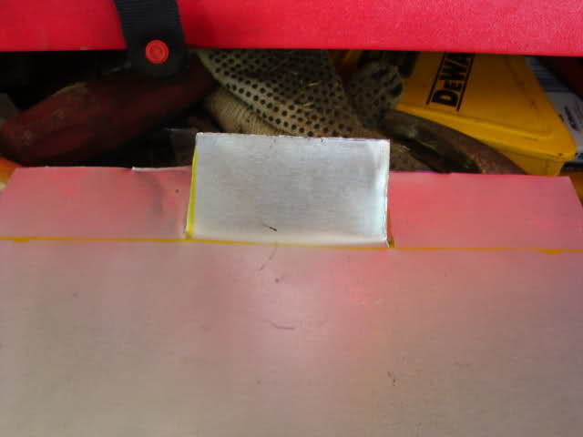

4. On the top I also decided to use the bumper mount. To do this i cut a tab in the center 1.5" deep and 2.5" wide. DO NOT CUT THIS TAB OFF!!!!
5. I bent the tab so it would go on the mount and mounted it with the bolts. I did not put the bumper on at this point cause i was just sizing it up.

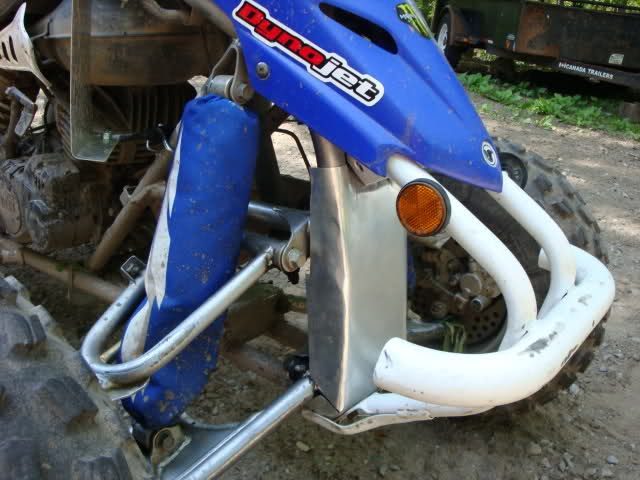

6. With a little trimming and hammering, I bent the aluminum around the bars and made it as square as possible.
7. I then took the bolts of an mounted the bumper. This surprisingly was the hardest part. The aluminum was gettin in the way of the bolts so some more drilling was needed.
Extra tips: I used shears for the cutting, they worked alright but they kinda bent as they cut so i need to bend them back to flat. Where gloves, the stuff I used cut me a couple of times. Be creative, it doesn't have to look exactly like mine, make it your own, I am just throwin the idea out there

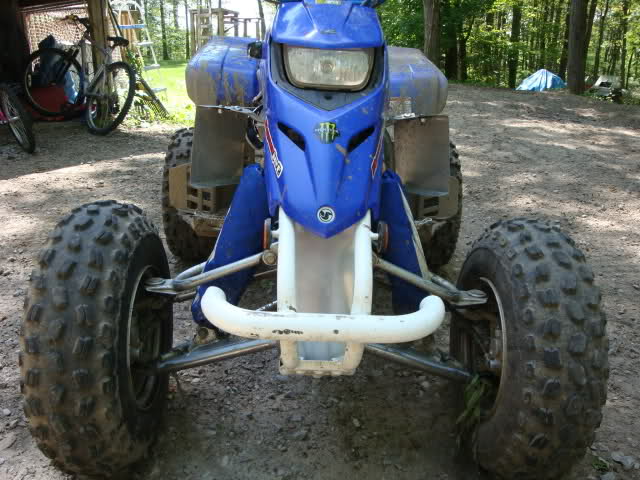

This is how it turned out. What do you think?
I know there are imperfections but i did this in about 20 minutes to kill time and i turned out liking it, might make a perfect one soon
