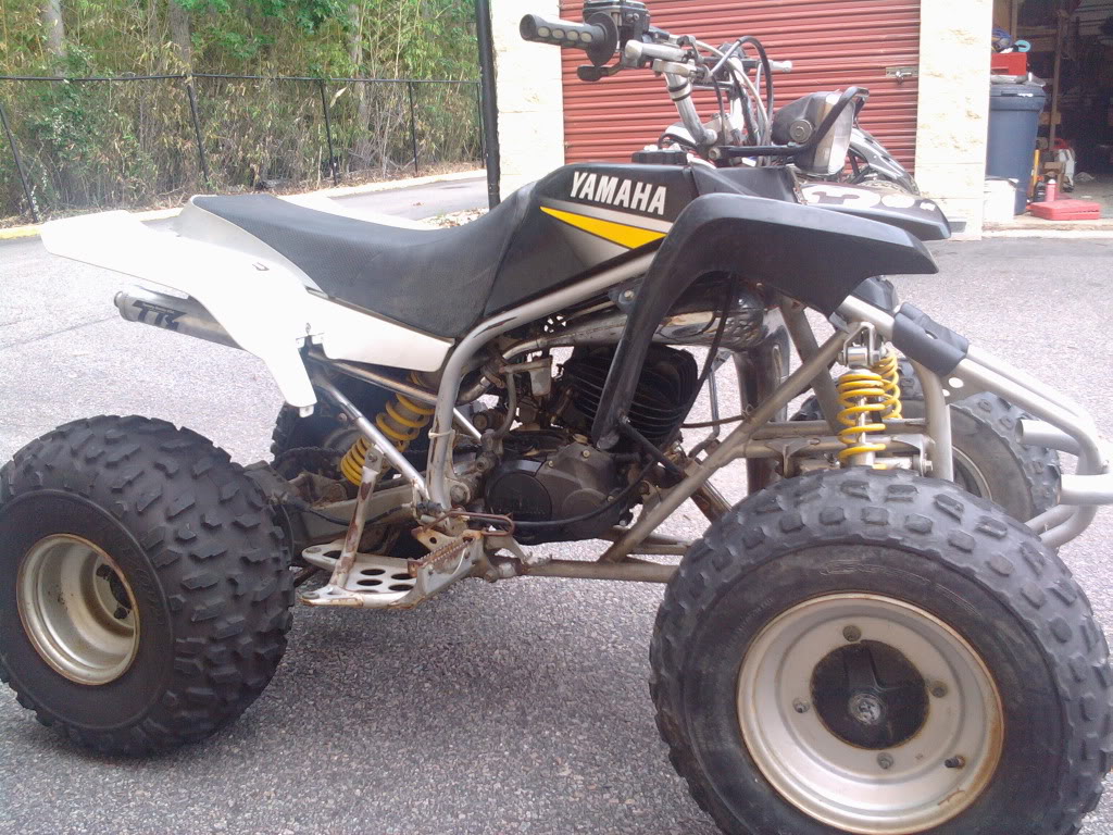

found another blaster

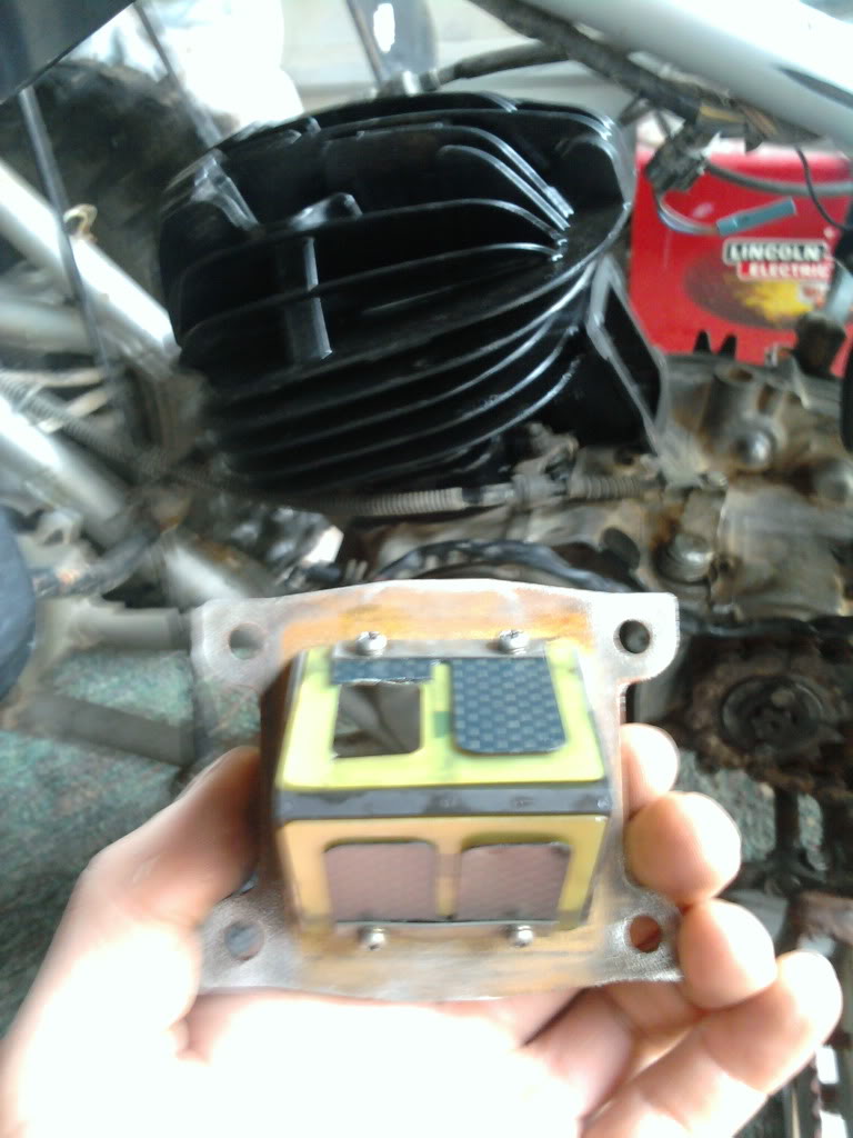

well i started this thing up and it ran ok for a lil bit but then a poping sound out the exhaust and it cut off. i tried kicking it to start it back but nothing. compression feels week, im guessing a ring caught the exhaust port?? i left right after that because i was a little frustrated. will update tomorow with results...
Pull it and see. A ring could have caught a port but it's relatively unlikely unless the thing was installed wrong or the piston to cylinder clearance wasn't right.
.004 is right on the edge for well chamfered ports. If they were sharp, .004" lets the rings slide out enough while the ports are open to snag one.
pop it back off and see what in the H happened. If it snagged a port, it's alright... a piston and bore and she'll be right then. You'll be able to run it for a long time after that.

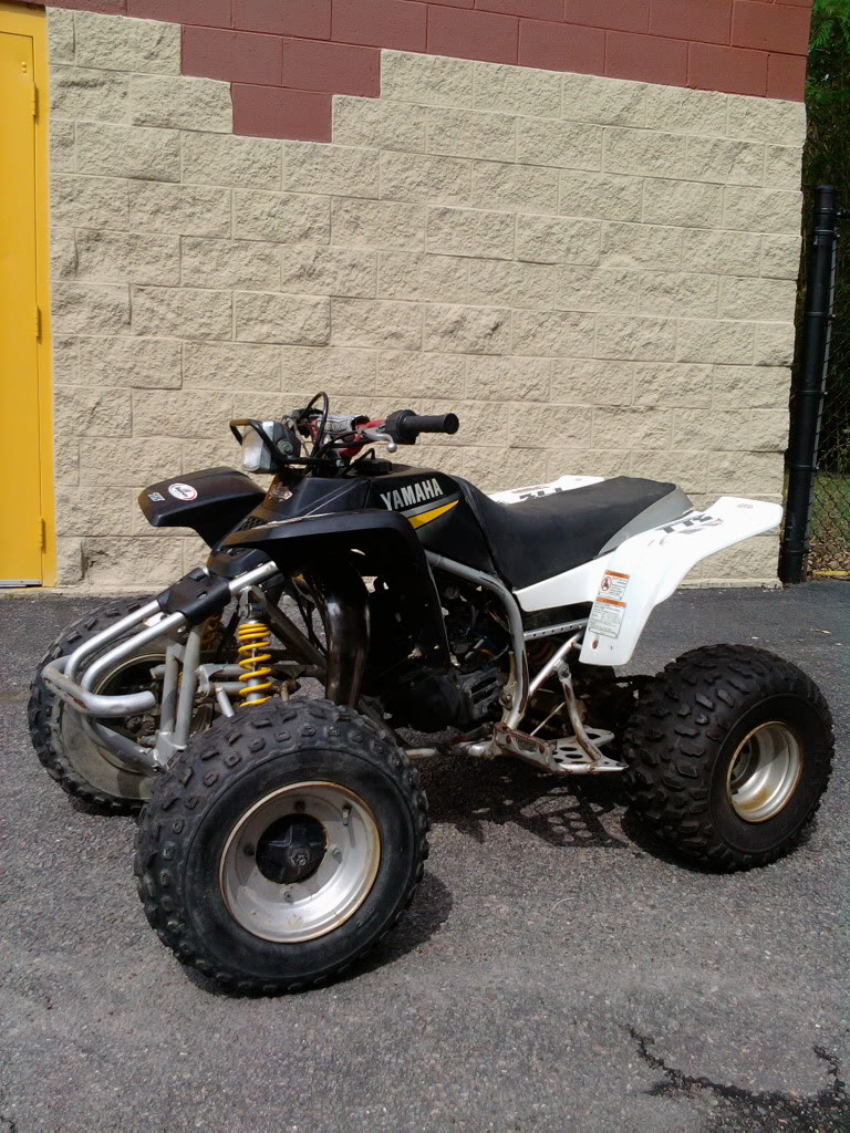

that toomey looks good i think you should make this your trail quad and turn you other that last step to a full out drag we know the other has the power lmao
im going to make my banshee the trail quad and dragrace the blaster i think.
i wonder if this was my problem?
all together!

My older blasty loved to eat reeds I had to feed her every couple months or so LOL....I refused to put the reed stops back on.....running at top speed tends to break there backs LOL the cost of fun you gotta love it
got it running good today. i ended up taking the jug back off and going with a 68.25 piston so its on its last bore. also put my rad valve on it. did some breaking in today and maybe this weekend get to take it out.
