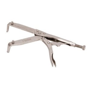

you need the flywheel holding tool. the two holes on the flywheel are made to have this holder on it
Yes the large washer is behind the nut. I just try to hold the flywheel and the nut wont torque. Maybe i need to buy the tool trying to use one of those rubber holding tools doesnt work. Tried a large set of pliers that resemble the holding tool. I held flywheel while girlfriend tried to torque nut wouldnt move. Seems like its on tight and flywheel is turning when i kick just cant torque to 53 lbs. This blaster has been a nightmare no spark no compression waiting on a cdi since everything else is replaced.
