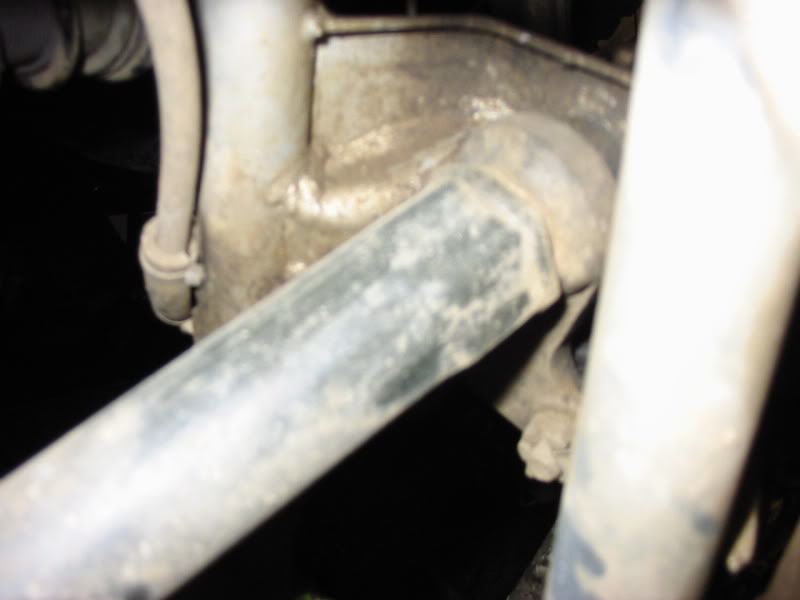

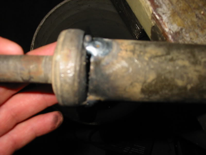

Length is the same, only difference i seen so far other than what is above is (Only due to making and extended one is the bottom of the stem on some have a hex shape and some have a smooth round shape). No size difference at all!
older style not sure what years had this but this was on my '89-(yes it was tack welded as i forgot to measure it before i wacked it of!
newer style this was on the '05-
