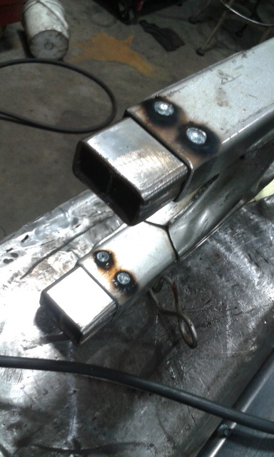

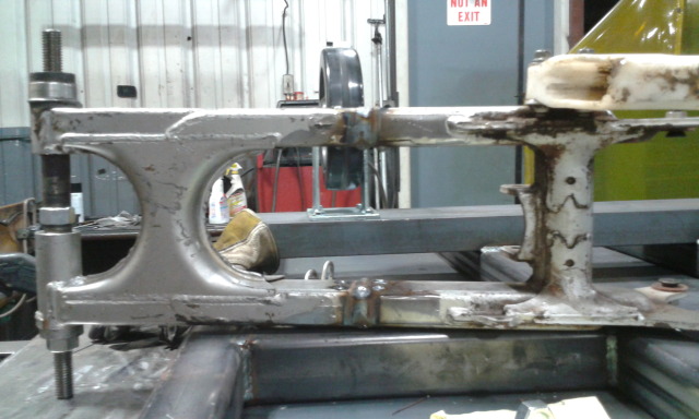

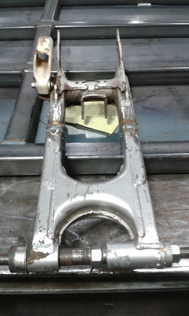

I looked back at you swing arm, I did mine the same way but haven't gotten the shock mount on it yet. I'm setting mine up with a 400ex shock mount. I got the mount bored for the 400ex shock bearing but don't have it ready to weld on yet. Here is mine
Lookin good,i braced mine on the outsidealso, and went long as i could on the inside wall,making it 3 layers thick lol.overkill i know.But why do it 2 times?
The piece i used for the shock mount i took off of a road bike and drilled the extra holes.
