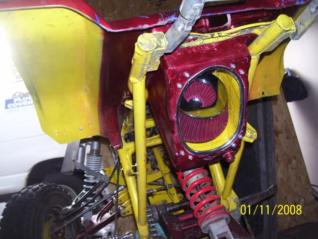

pretty much just cut a hole in the side and used peices from my old fender as a little scoop, then i cut the bottom off flat and used another extra peice to fill that in
some fiberglass bondo paint and clearcoat shes done

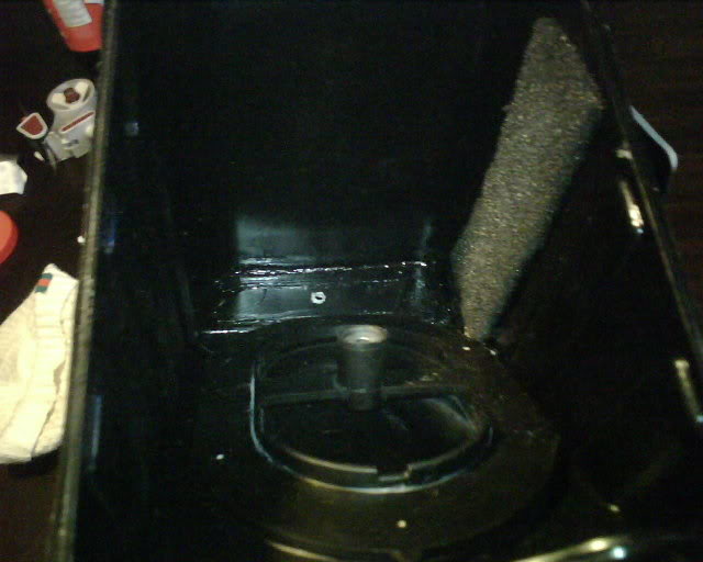

ya i was runnin just a k&n right off the carb with a outerwears on it but other day i hit a puddle and sucked up a grip of water. it was kinda hard to start i had to kick it for fifteen minutes. i dont ride in sand that much, i live in southern washington so im mostly riding trails and sh*t. im designing a custom airbox right now, its really simple. im just using radiator hose and i built a sheetmetal airbox, used some pop rivits and some clamps. almost done, and i only spent like five bucks total. i will post some pics soon.

i wanna see that when you're done. cheap and awesome sounds like my kind of build.
