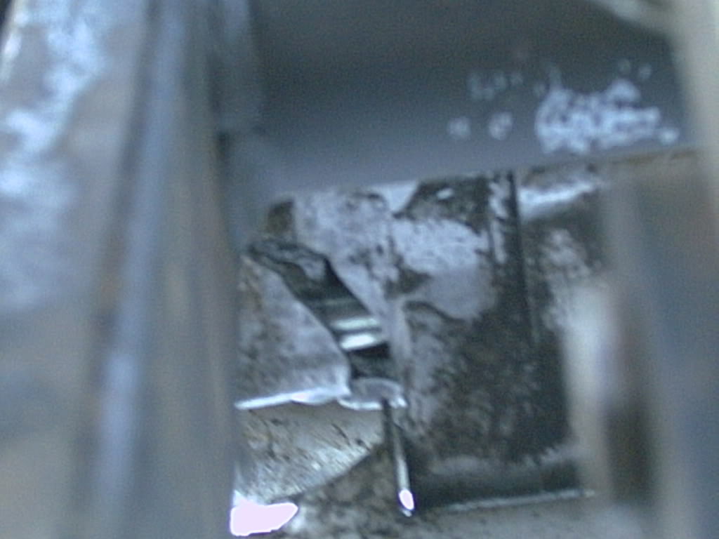

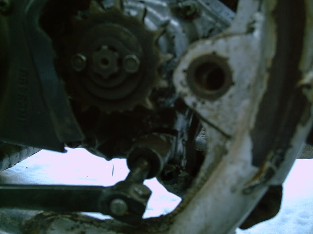

Here's some pics of where it cracked off:
I am thinking about trying the JB weld first,since I have some already.Or wouldn't it be strong enough to hold the whole piece back on around the shifter?If not I am going to get some of those welding rods from harbor freight.I do however have a bottom half of a motor that needs some work,I could just transfer everything into it.What would you do...?

That looks a bit tricky....it would be eaiser to pull the engine and preform surgery on a work bench....hope you can weld it...like stated above, jb weld probably wouldnt do....maybe you could weld it, then try some RTV Gasket sealer around the weld...might work, but wouldnt hurt
Yeah,oil poured out of it.I thought that the shaft looked a little bent.I am hoping it just looks like that because the piece is weighing it downward.
