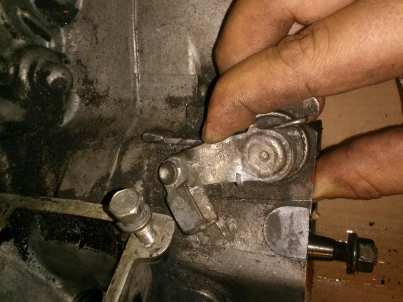

is the clutch adjusted properly. not the cable..
the clutch actuator/lever has a point on the end of it... it needs to line up with the little point on the case.
here is a picture of a clutch that was WAYYYY out of adjustment
to adjust...
remove clutch cover
loosen 10mm nut in center of clutch pack
hold clutch lever, pushing towards front of engine
turn screw inside of 10mm nut until point on lever lines up with case point
tighten 10mm nut
the clutch feels sooo nice when properly adjusted
