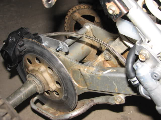

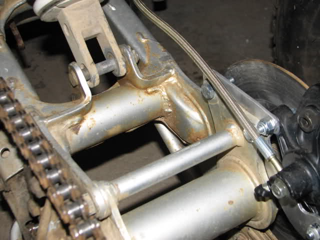

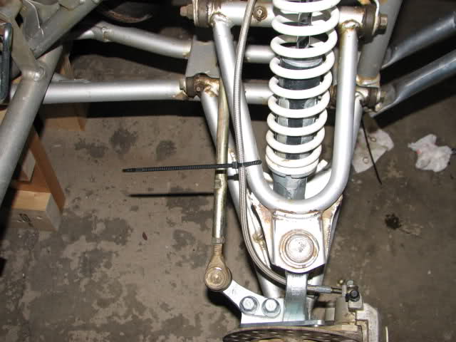

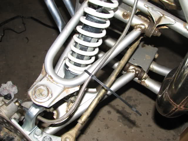

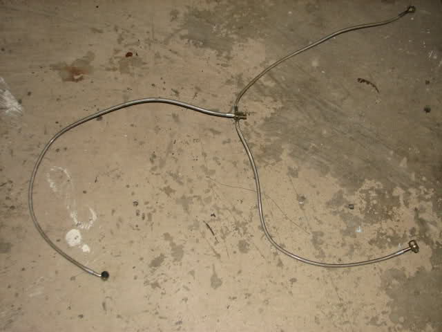

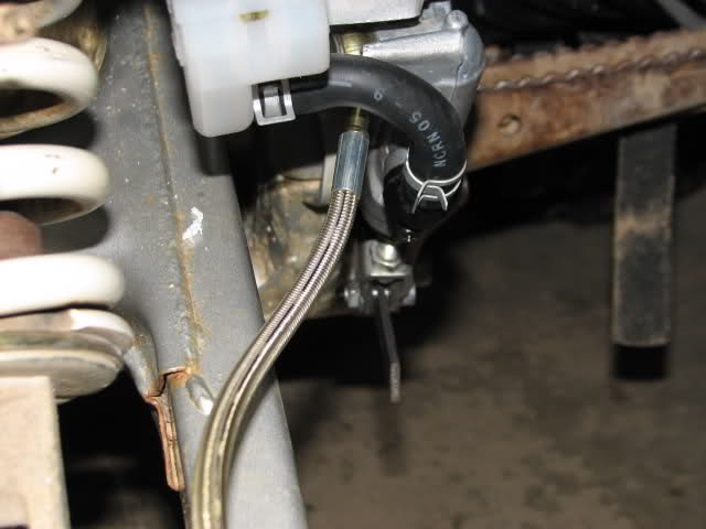

Well these are about 95% installed and I am going to call it a success. The rear line was the perfect length for my stock swinger with GSXR master cylinder and caliper mounted on AWK's brackets. The front lines fit well too. The top part of the line was a little long so I just made a small loop under the hood to make it the right length. I had to use the Yamaha banjo bolts on the front and the GSXR bolts on the rear because the Polaris bolts have a finer thread. I did use the washers that came with the Polaris lines. They have a rubber seal built into they instead of the standard flat copper washers on my other lines. I just need to install my a-arm clamps when they arrive and a tab to mount the "T" for the front line. Not a bad setup. So if you are interested in replacing your lines With braided stainless ones but not so sure about the price of aftermarket ones, these would be a good choice. Got mine for $19.50 shipped. Here are some pics. Enjoy.
The front line before install
Left side with the "temporary" clamp
Right side
Upper section. Notice the loop near the voltage regulator.
Rear line
