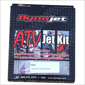

I got myself a dynojet kit, specifically for the blaster, which contains both stage 1 and 2. Stage one is for stock engines with an aftermarket air filter and stock pipes, and aftermarket air filter and pipe. Stage two i believe is for ported engines etc. but i am pretty sure if you have a ported engine you know how to do this, or had it done.
This is the kit i used, although this is for a rhino, not my pic.
I won't tell you the settings, because it is best for you to decide from the instructions they give you. These are contained in the kit.
