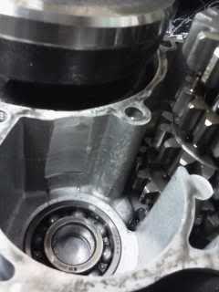

Well finially got my cases split, and look what I found. Its a hole in case where crank shaft is. Got some play in bearing for counter balance and it must have hit side and made hole, and wore some on side to. In one of the pics you can see all the shavings in the corner. This started out as a engine that was getting too much air and didn't hold a leak down test, and I see why. So much for just replaceing gaskets and seals. I was kinda having fun on this project till this. Now what??? Do I have to replace both cases? I need some advice please! Thanks!

that sux man! can you tell what caused it? you should only need to replace the side that is missing peices. however you might find that its cheaper to just buy a set. there is a set in the for sale section that you can make an offer on. be sure and lap your cases before you put them together if you only get one side. good luck!

You probably don't need to replace any of the bearings but the main crank bearings. You would need to thoroughly check all of them to make sure but it's unlikely there's any damage to the transmission bearings. Unlike the main crank bearings, they run in oil bath all the time and rarely get damaged. If you can find a set of main crank bearings and seals, put those in and then check each of the other bearings. If they're smooth, rock on!
