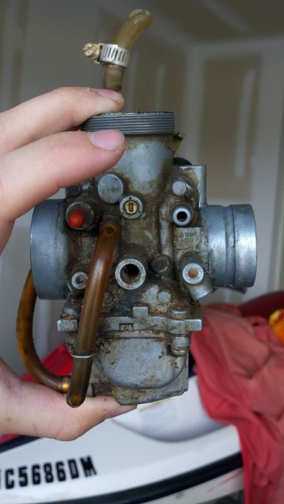

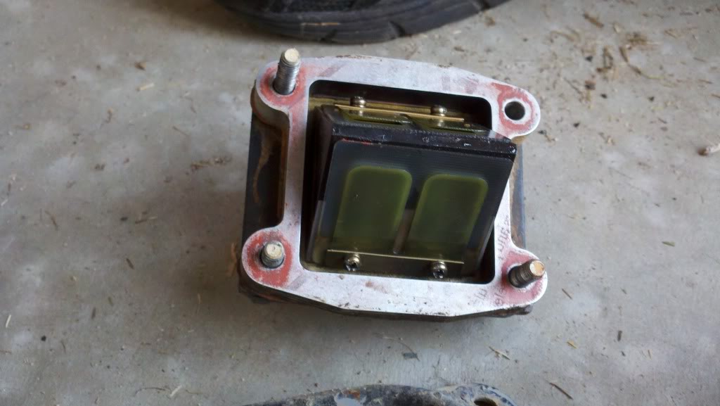

Here are pics of carb and reed valve
yeah dual stage reeds are nice , I have a set in mine as well . I would suggest +4 on the swingarm , Its the sweet spot for the blaster IMO , thats whats on mine as well . 400 ex rear shock is one of the best and least expensive rear shock upgrades you can do , and PM Ken Oconnor here to get a set of his 400 ex shock bushings that make mounting it to the blaster a snap . check out aftermarket a arms as well , My blaster has +3 +1 long travel a arms with honda 450R front shocks , she floats like a butterfly and stings like a bee !!! good luck , have fun and if you are currently dating or married , you should just dump her now . The Blaster will take her place.
