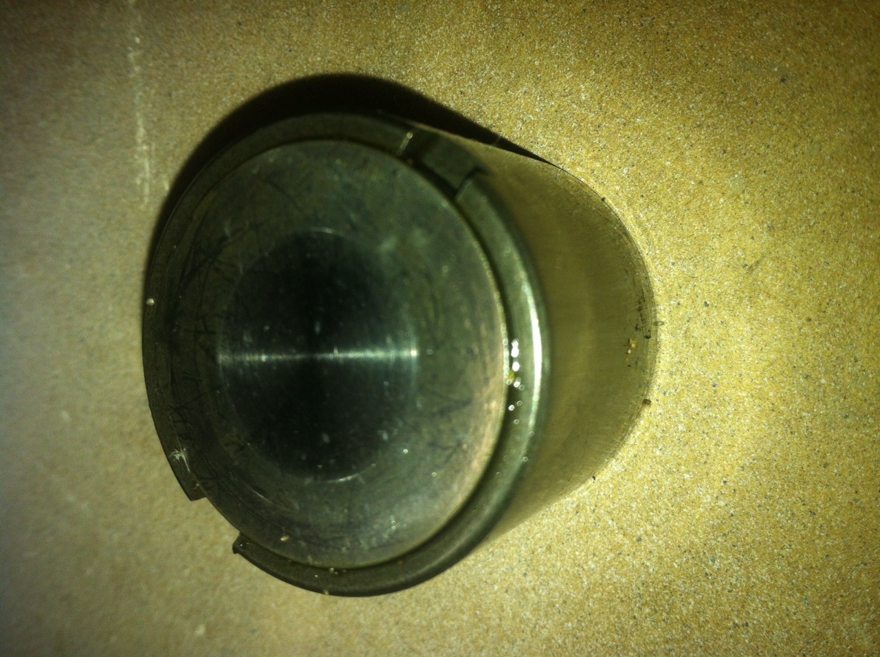

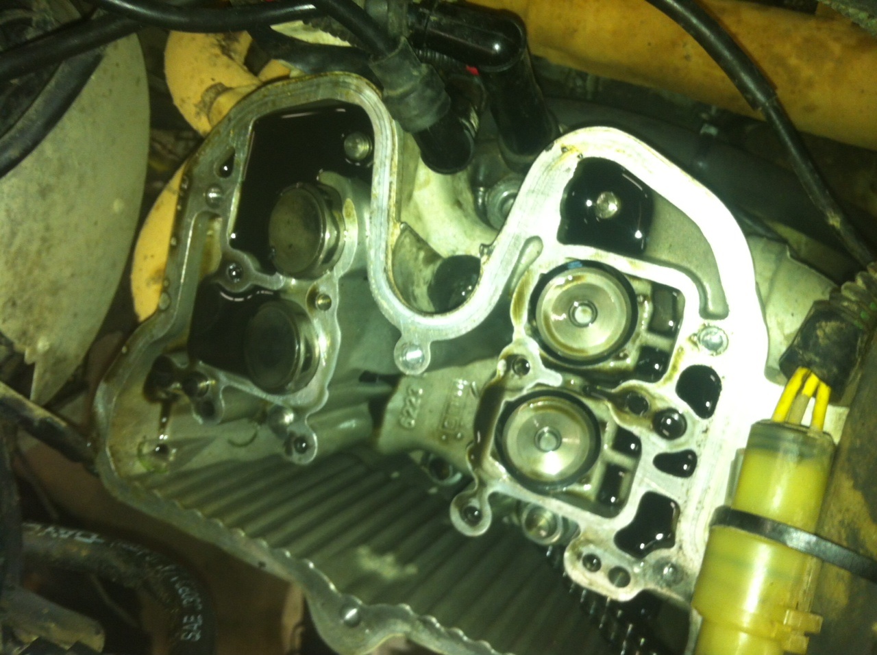

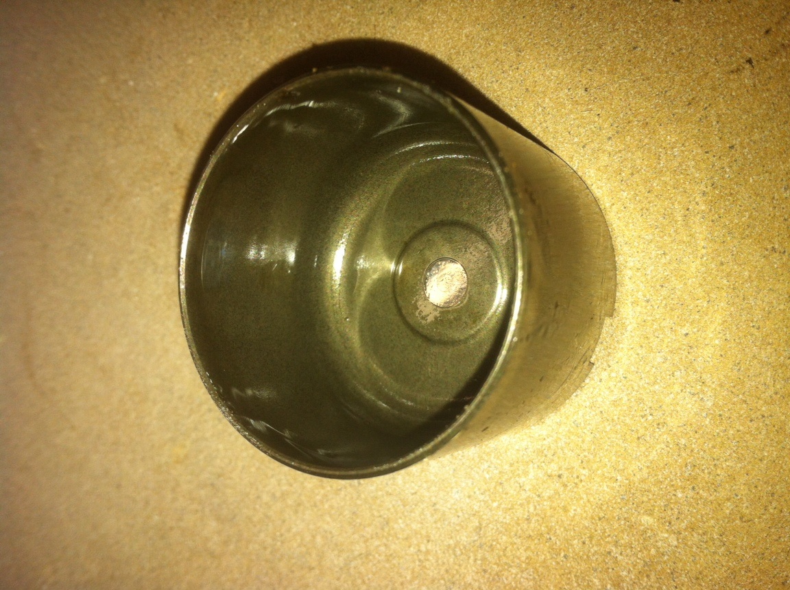

Ok so I have a bombardier ds650 baja x an it wouldn't start so I decided to check the valves.. Anyways the intake valves have 0 clearance so we pulled the cams out to see if we could remove a shim from the bucket or something.. Well nothing can be removed so what could I do?
It sounds like the valves have bitten into the seats.
At a last resort you may be able to remove a small amount of material from the stem.
Not a job for the faint hearted.
