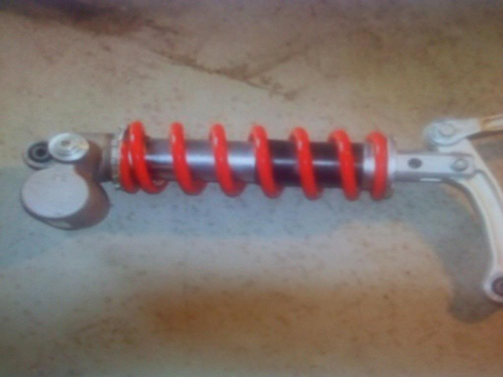

[/IMG] and also my uncle noticed my shock was gone and was bent so he got me a 400 ex shock and a kit from ken got the shock for 30 bucks with only 5 hours of rideing time. ps still in shipping haven't got it yet.
