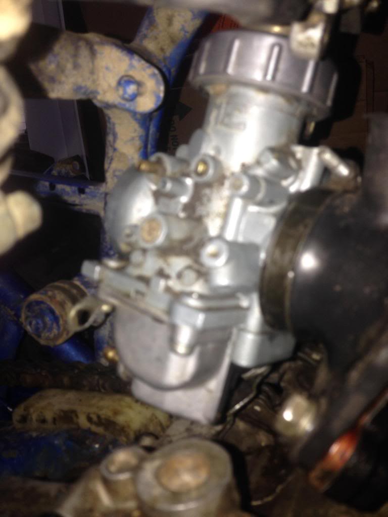

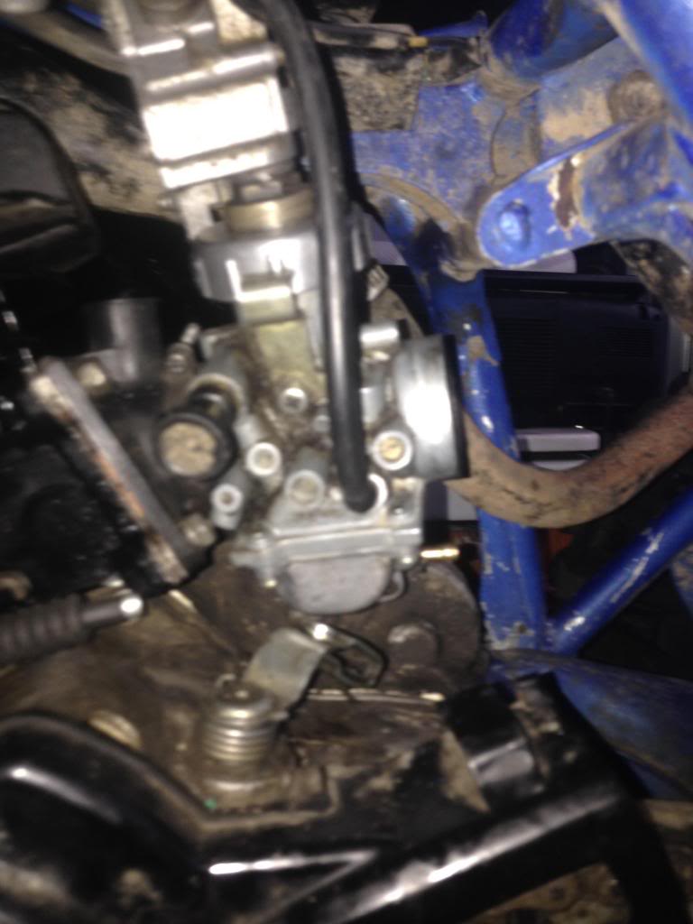

I didn't see this mentioned at all but I have to ask...is the idle turned up enough to where it will start and idle? Is the air screw adjusted right? If the oil injection was removed was the carb nipple blocked off?
Ya I've been screwing around with the idle and air screw. But the oil injection thing is not blocked off.. Surprisingly nothing on the carb is blocked off. I took pics I just have to figure out how to upload them.
If the oil injection nipple on the carb is not blocked up, you will be running a dangerously lean mix at all throttle openings.
Premature death of a fresh rebuild is imminent.
Every other tube should be open to atmosphere.
Idle adjusting.
Set float level, make sure that all jets are clean and fuel flows freely from the float bowl drain when the screw is cracked open.
Start with air screw 1.5 turns out.
Set idle screw so that it has some sort of idle. With TORS it is the big screw under seat on top of unit. With no TORS is is the brass screw midway down carb body.
Warm up motor and then set idle screw for a faster idle, 2000rpm+
Adjust air screw either way to get the fastest idle.
Adjust air screw a little at a time leaving 10 secs or until the motor responds.
Re adjust idle screw for desired idle .

No surprisingly none of my friends have pullers. Sorry the pics are so bad my iphone can't take pics for crap. Would it not being covered cause it not to run?
