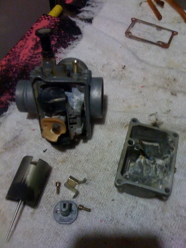

Next I move onto cleaning the carb and take it apart to find this
So a friend of mine offerred to clean it up and rebuild it for me. Came back looking like this
