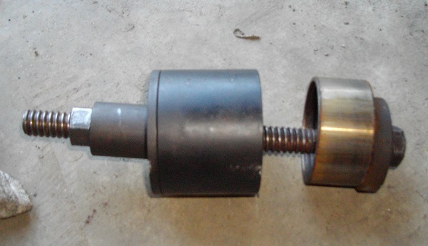

Or use a threaded all tread and nuts and sockets to remove and install in bearings. I have made one before and worked mint. Kind of like this photo.

Oh and that tool will not be very useful for removing them bears unless you can get one bear out. but tool is perfect for installing them.
Works like this But a longer threaded rod is needed for doing front wheel bearings and axle bearings. Wish I made a video of me doing it. Maybe I should when I go to install new bearings. Kind of works as a press. Also works good on removed bearings not just needle bearings
