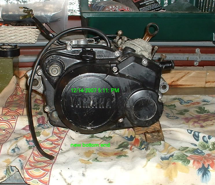

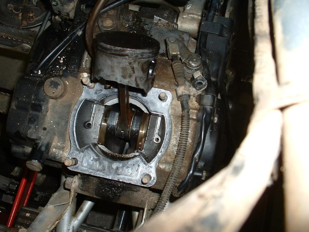

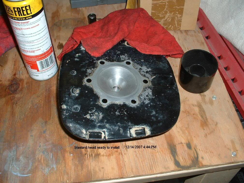

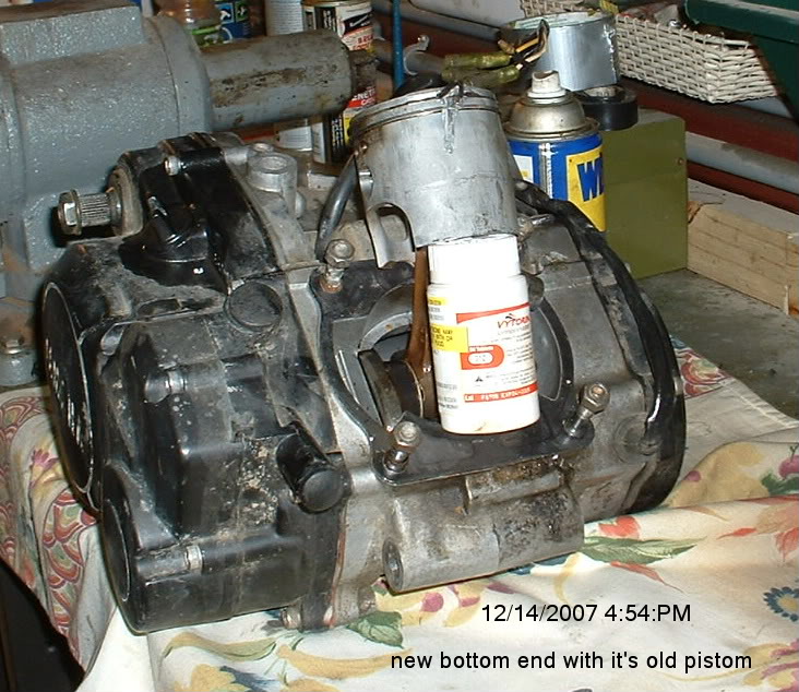

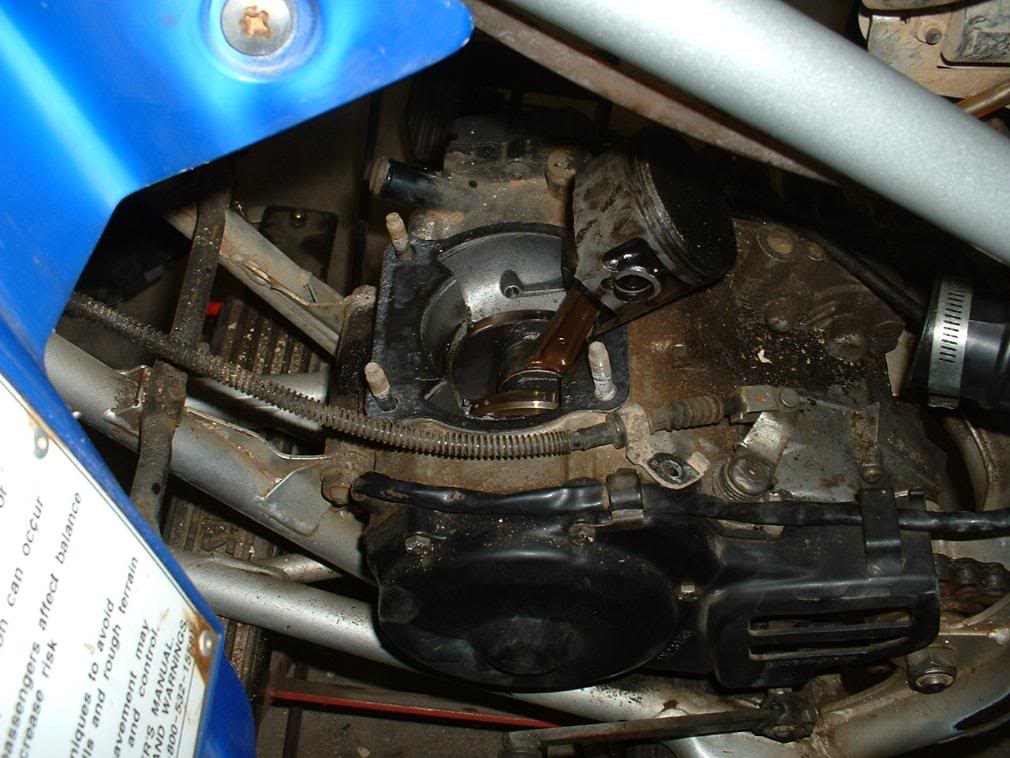

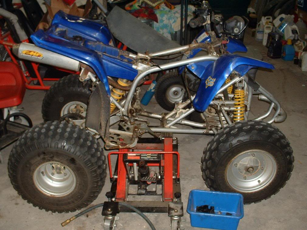

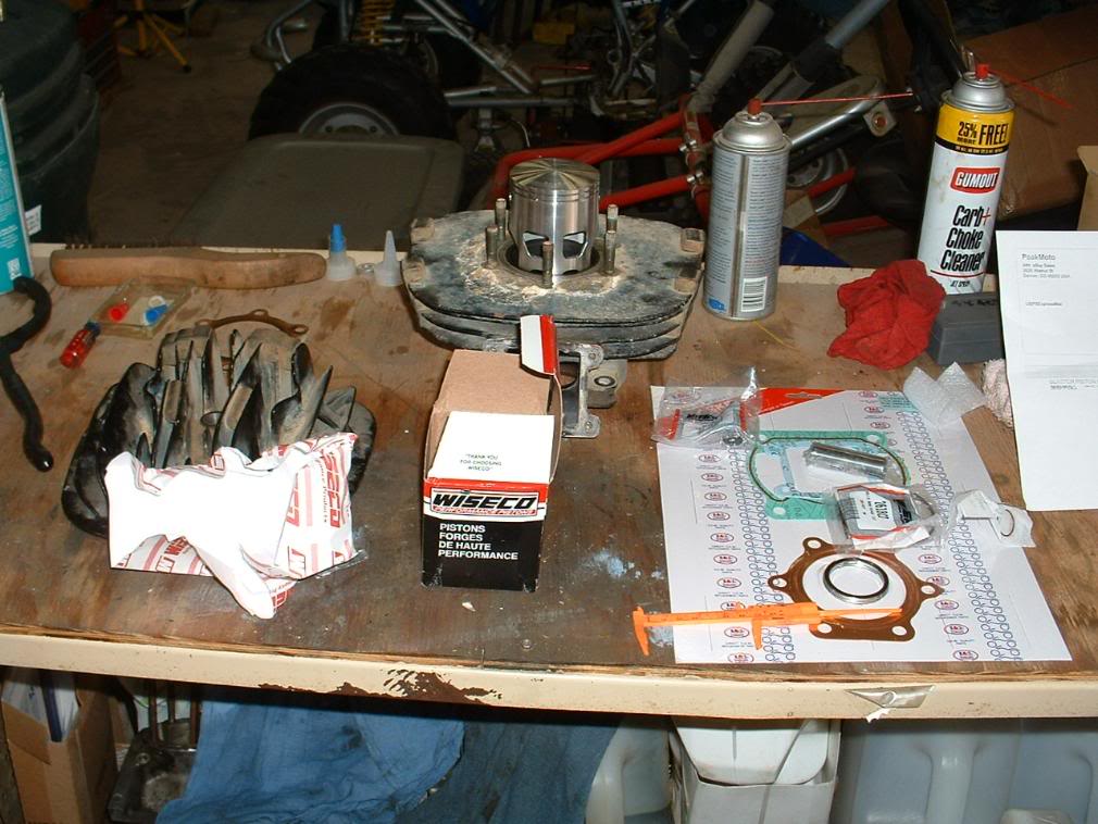

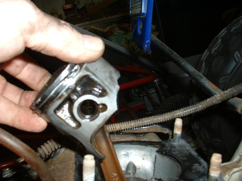

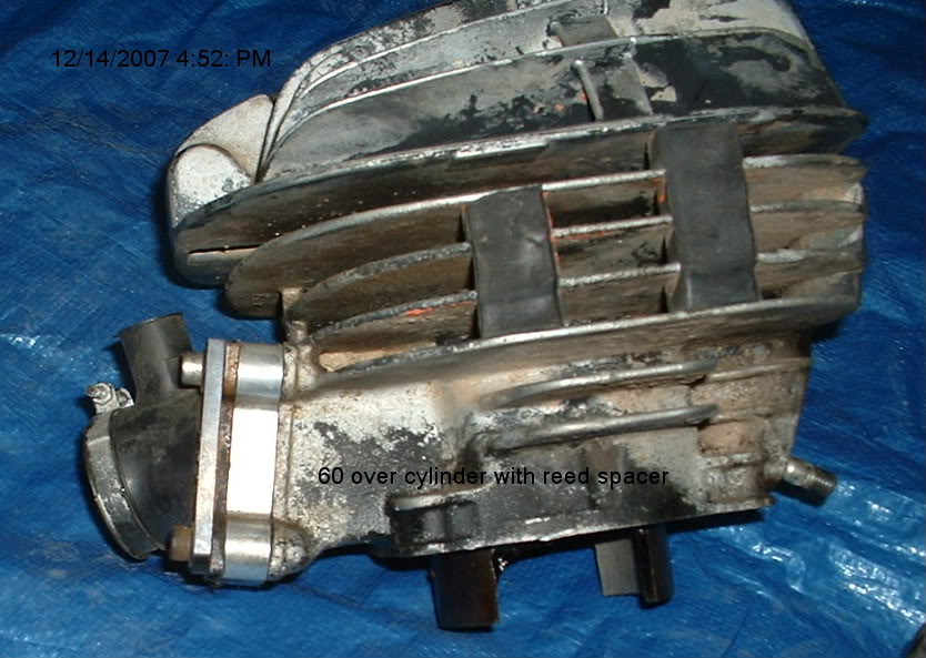

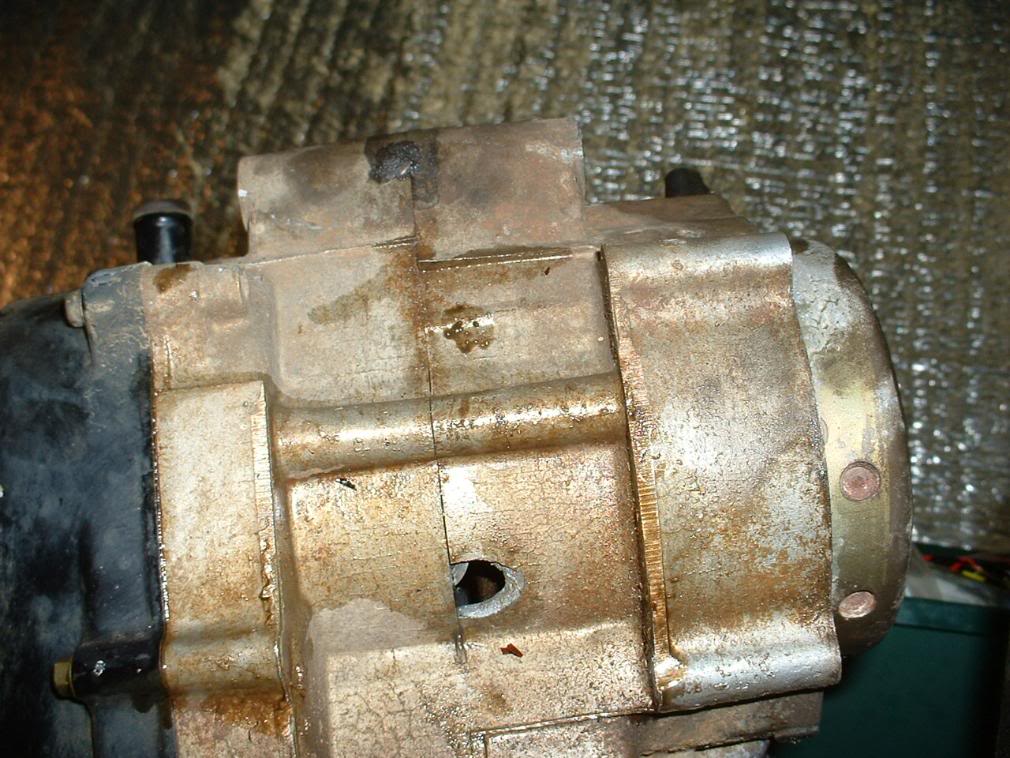

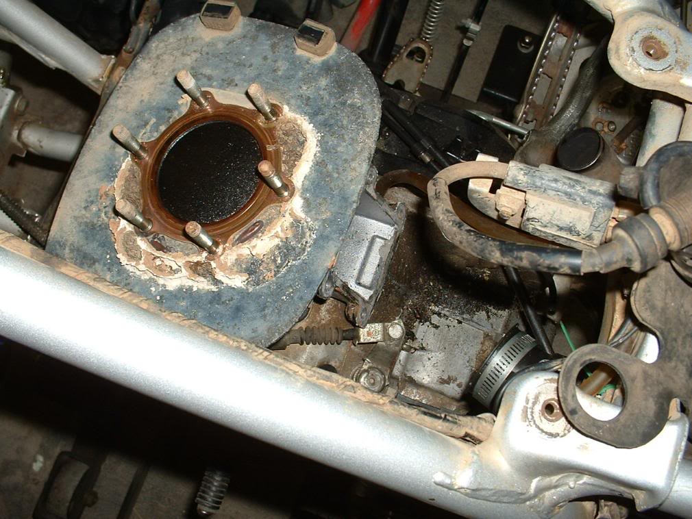

I was in the middle of a nice 2nd gear power wheelie and the motor suddenly ceased operation. Luckily, I had 2 fingers poised over the clutch as I always do when riding a 2 stroke and managed to keep from getting thrown over the handlebars. Carnage pics follow, bidding on an 03 motor complete ,funny the only thing undamaged is the bore,it is perfect and was the original 18 year old ARt factory piston. If I can't find a motor cheap I'll fix this one, worst case , a set of crank bearings and seals and get the case heliarced ,then hand file it til it's level and bore the cylinder to fit a new 1st over Wiseco. You Play You Pay...
mud daubers
carnage 1
carnage 2
carnage 3

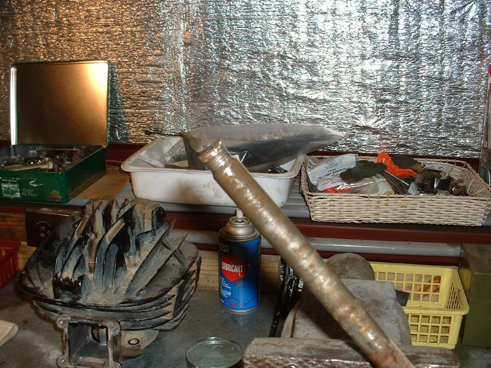

18 year old swingarm pivot bolt (removal required for engine removal) after 3 hrs of heating beating and cussing:
