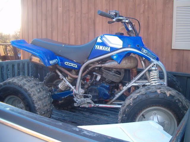

1 have a 93 blaster i kick and kick and kick and nothing and kicking it over doesnt feel like there is much compression the seal on the shifter is gone so crankcase wont hold oil. But here is the weird thing drag it behind my truck 10 15 feet pop the cluch runs idles away and starts first kick after that? what gives?:">

update !!! I cleaned the carb and with my 80 psi cold compression i pull the choke no gas and 2 kicks starts everytime now the screw on the carb was out 2and 1/2 turns i set it to 1 and 1/2 thats all i did and bingo she starts!!!
Runs nice!!!
