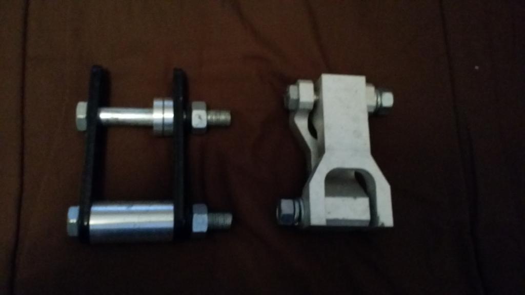

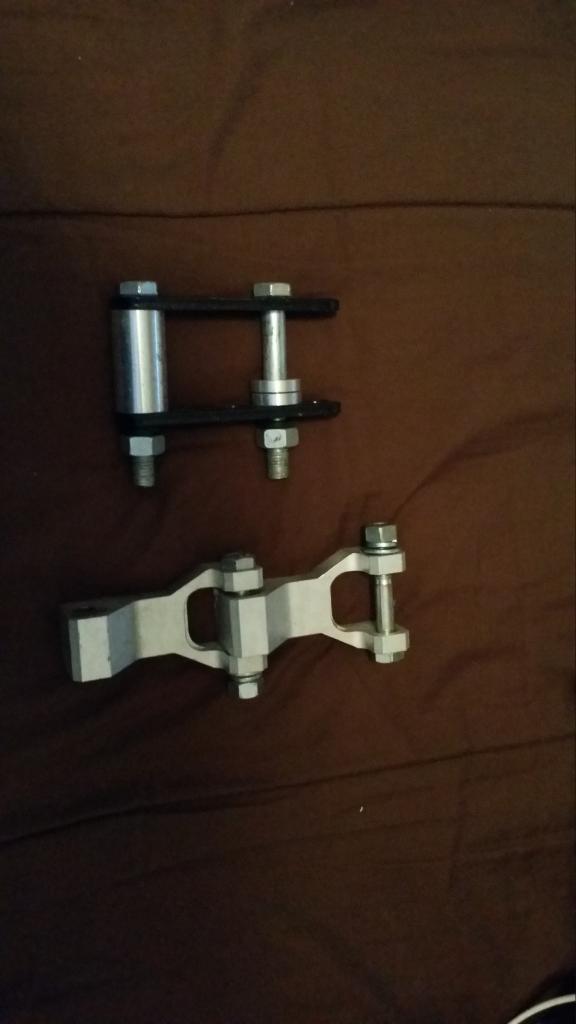

Is used the Diamond widening and lowering kit with Banshee axle and stud spacers., with a cheapo rear lowering device.
I will not say that I used the best way, just showing you a cheap option, everything works great!

those front ones can not be trusted. they are not rated enough to take heavy mx. for street riding (no jumps) they would work fine im sure
the back one.... its kind of hard to mess up pieces of steel aint it?
it says directly in their ad "This is primarily for flat track racing. (These are not recommended for heavy jumping). "
lower by 3.5 inches and widen 2 inches
yep I agree I bought those because I primarily run on the street
imo shorter shocks would be better for the front like bayou 300 shocks are shorter and will lower it about 3" if im rembering right and the back id do like blaasters pic I made me one like that out of some angle steel and it heald up pretty good
