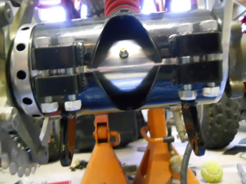

that is a round house swinger. it takes a different axle carrier than stock. but the roundhouse carriers are dualbearings so you have 4 axle bearings instead of 2. with grease fittings. but the carrier isn't cheap either.
here's a pic
Awesome ;) Iv Just Posted A Thread Saying What Im Getting Done So Im Sure I Can Get Another Axle To Fit! Do You Get Better Handling With This? Also what axle fits just im making a list of things im getting done. @ Scotj77 it won't be stock for long :) im taking everything stock off it. check out my other thread with things im getting done .
a banshee axle is wider than stock. and works on the blaster with very little work. but good luck with the build man. keep us posted
Will Do Man Im Going To Be Spending Around £2000-£2400 On It Within 8 Months So Should Be Good At The End :) Will Be Updating My Albums In The Time Anyway :) Is there a axle for a blaster thats wider and would fit this? i said in the thread i just posted money isn't a issue so i can spend a good bit on parts. just can't wait to get money coming and get started! :D
