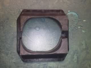

It says the body as been modified to take a bigger carb u think this will work ok on a std carb?
Just use a stock intake boot with the nipple cut flush a little rtv and you will be ok.
We demand pics of the VF3 Cage modified! I have done some porting to my VF3's my pics VVVV
CONE REMOVED-
FINISHED
Forgot to add, when you look at it, make sure all the reed peddles are laying nice and flat with no gaps and there no chips or cracks in the feed peddles.
Looks fine to me you will just have to modify your stock intake boot (cut off the extended nipple) there is a pic on here on how to do that.
If the reed petals are good, I'd buy it! $70 , would still leave you a 2 week supply of beer!! Over buying a new one! I:I
