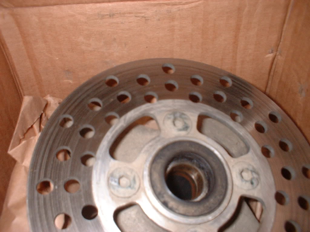

Can you use any year banshee front hubs and rotors for the front hydraulic brake system or does it have to be a specific year?
any year will fit, but the pre 91 j-arm spindles have non recessed bolts for the disc, and they will hit the caliper after it's bolted on
91 and up a-arm shee's have recessed bolt heads that will work
now whats the best way to hook up the front brake system i have banshee hubs and rotors...is it better to use banshee spindles and modify them or buy the yamaha blaster disc brake hydro conversion spindles?
91 and up I believe.
but i apparently have 87 warrior front hubs/rotors and they fit on my norman spindles. so maybe the older shee ones will fit too
I don't know how yours works then, on my warrior I have 94 spindles and calipers and 87 hubs and the bolts that hold the rotor on the hubs hit the brake caliper. I can't even bolt on the calipers. I bought some newer style (91 and newer) rotor bolts hoping those will solve this issue because I don't want to buy new hubs. Can you get some pics of the back side of your hubs??? Or how its bolted up? Just want to make sure That If I can use the 87 hubs on the norman spindles and not have them hit the bolts.
well, seeing as how i just removed my discs from the hubs to paint, i don't think different screws are gonna work, the disc itself has recessed holes for the screws to sit down in, assuming that the pre 91, old style non recessed screw discs would have no reason for recessed holes in the disc

Not a huge deal you need (8) of item 2 on this page
World of Powersports' 1998Yamaha ATV BANSHEE YFZ350K (3GGW) Parts Image
A drill press, and a 10mm or an (X) drill bit.
Drill through the rotors and c'bore the hubs slightly (1/16" deep or so) with the same bit. You may have to grind a little off the ends off the stainless hex head cap screws I send you. You can do them one at a time with the rotor left on, or remove the rotor and do them seperately. I've done it to a bunch. Often the parts I buy off of Ebay are not what people think they are.
They are 3 bucks a piece if you buy them new or use Yamaha rotor bolts as a search on Ebay.
