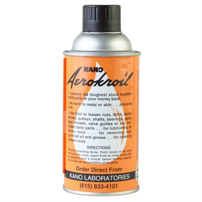

:o :o :o Good luck on sprocket hub. Start by soaking it with PB Blaster or equal. Let soak, repeat. I have seen some destroy the hub to get it off. I had a homemade puller, heated hub dull red , hit puller bolt with 2lb sledge and it still wouldn't budge. Bought complete good axle/carrier for little more than auto parts wanted to press hub off. X(
KROIL. little orange can, this stuff makes pb blaster look like water.
it flat out works.
