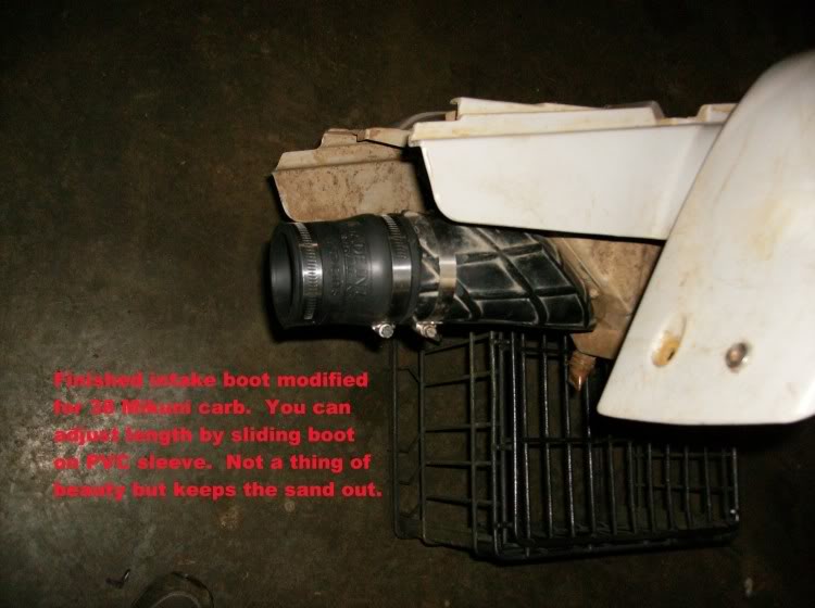

Here's a another version of that same idea. This was for a 38mm but ya just choose the right size coupler for your carb. Not real pretty but it worked.
