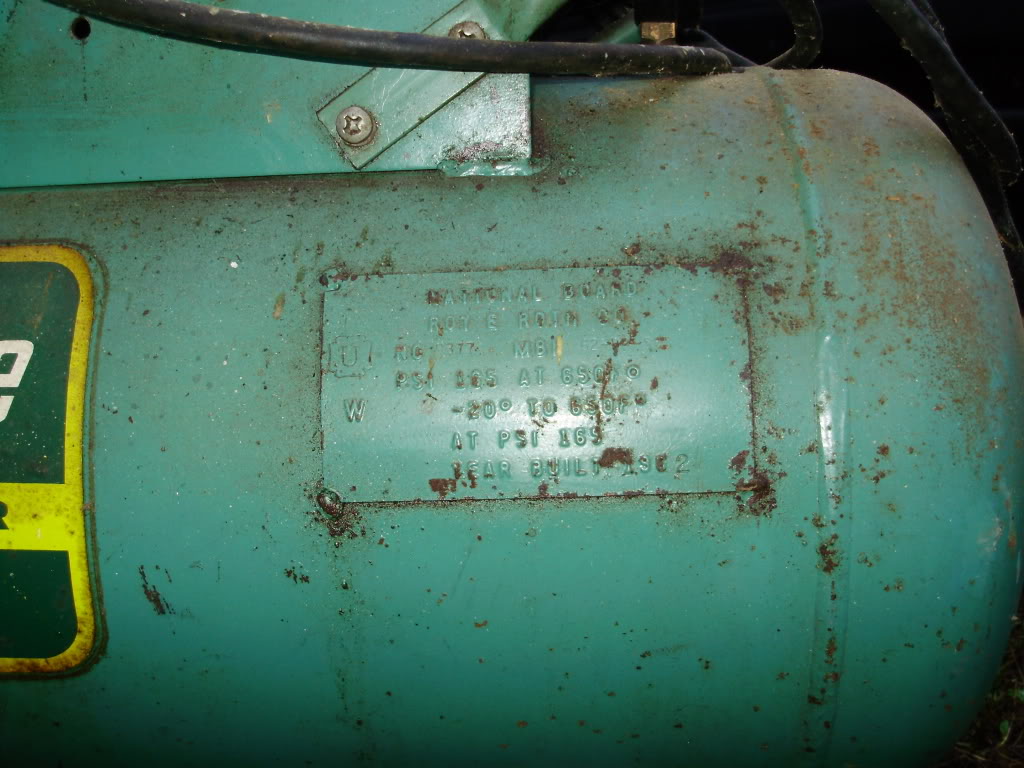

@Blaaster: I figure the age of the tank is WAY worse than my patches.... Like I said, I'm not anticipating ANY problems out of those welds.

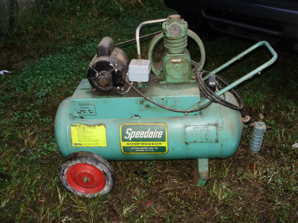

Heres a couple pix of my old pressor. Not bad for 49 years old and runs like a top.
It was my buddy dads then passed down to his son then passed down to me.
It's very quiet but doesn't quite have the power in CFM's I need so it's on a well earned break haha
@ paulie: OH man that's an oldie but goodie.
