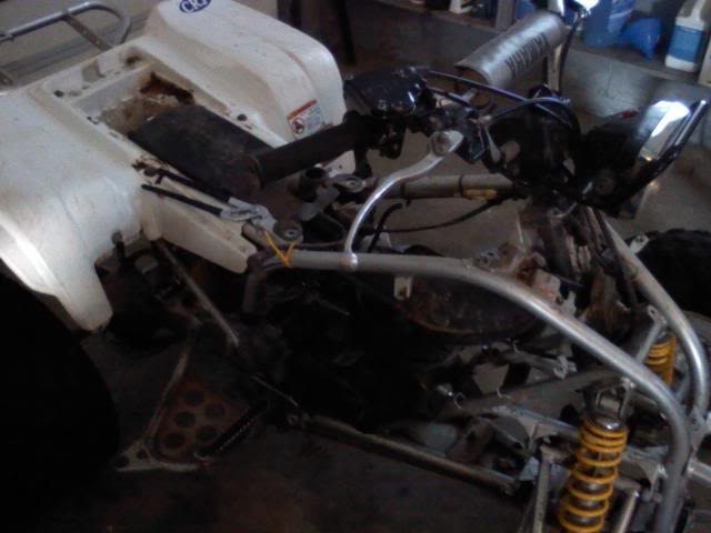

im going to start taking the blaster apart, probably just take the whole motor out and repaint the frame while im at it

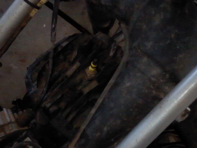

Yes... my spark plug is that yellow :(. Im taking a break now
after i take off the exhaust, where should i go from there? Just take off the head? I'm beginning to think this is a bit much for me, haha.
