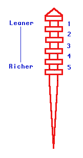

ok so your telling me my setting is currently lean (on the needle)?

this is what i found my clip is currently on space # 2 going V in direction from top
try the middle clip, i've never had to do any other clip besides the middle, on my stockish blaster with pipe/filter/vf-3's

To my way of thinking, unless you are using an aftermarket needle that usually come in a kit, position 2 is too lean.
Is the needle red or blue? A stock needle is usually ok on the 3rd or 4th clip position.

my needle is a copper color noe the clip is black float was adjusted by me because it was flooding its self ill drop it a clip tonight and see how it runs

Q10 has summed it up here.
Needle on centre clip should serve well.
