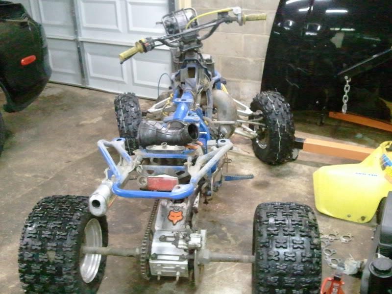

Tonight I decided to stop being lazy and install some of my Zilla parts.

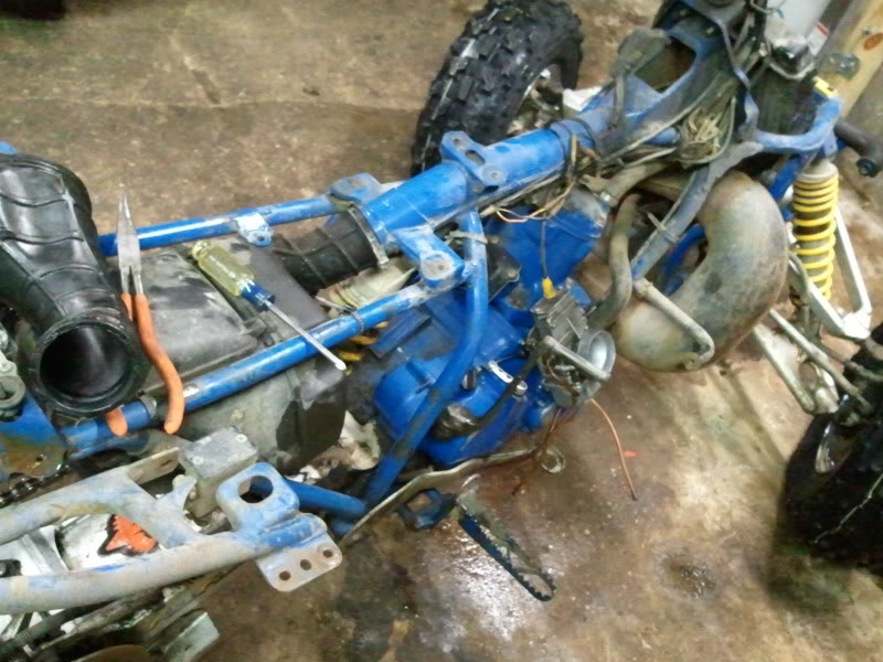

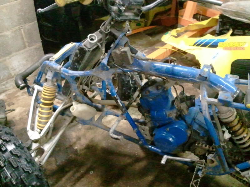

First took the beat plastics off
Took off the JUNK 87 stock carb
Pulled The Stock Pipe Off

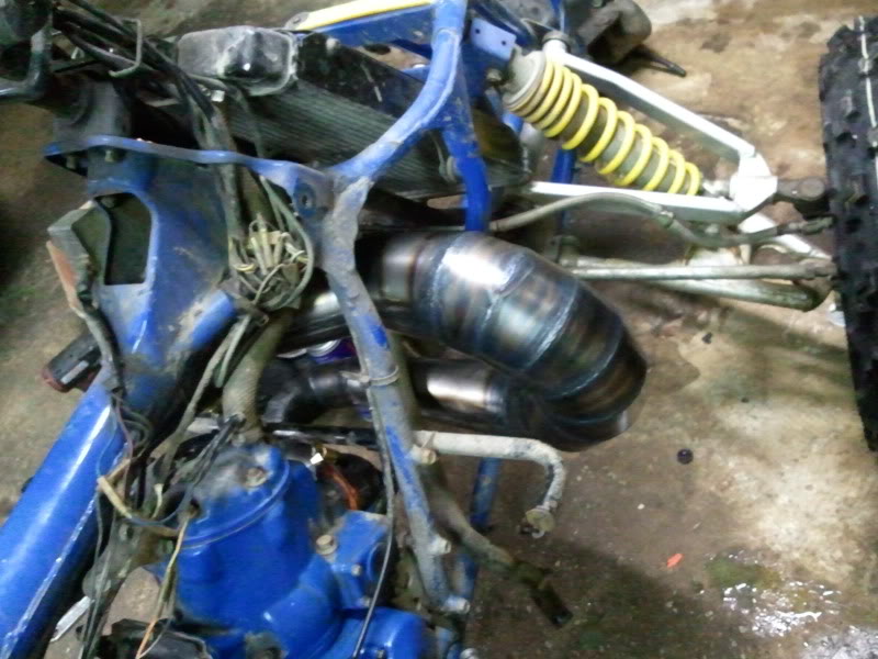

New AAEN Pipe Installed!

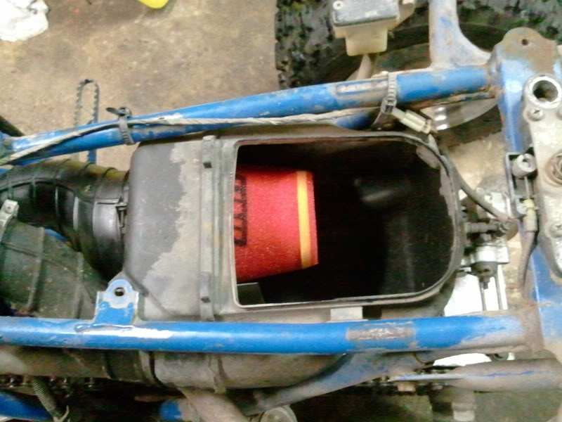

Got The Airstriker In Easily
And....the little UNI filter

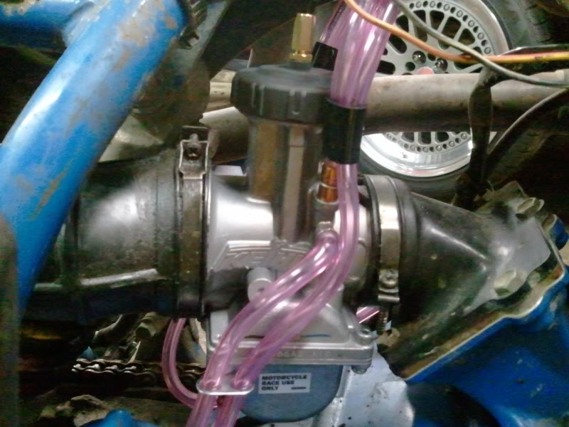

Took a complete guess on the initial jetting for the PWK38 A/S with 58 Pilot, 185 Main, Needle 4th clip from top(so almost full rich)
dead cold, first kick it fired and died cuz the idle was set too low
after a few adjustemtns with the idle screw and air screws
overall successful night, tomorrow more testing!

i dont like the layout of the aaen pipe, now it comes out to the left then 180 to the right then up and back out the left.
it remembers me of a DG pipe layout.
i say....nuthin like a hand built, individual cone, pipe, forget the layout, hand built cones are proven to be the best !!!!!

and shee, i see they changed the design, but i'm sure they did it for a good reason. i don't think they would make it an inferior design just on a whim, i'm sure they knew what they were doing. the sound of the exhaust pulses sounds nothing like a DG or FMF pipe while its running too.
