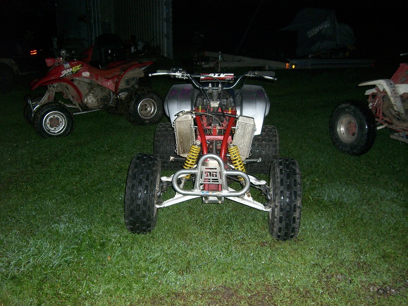

'99 Kx 125 in blaster.
Radiators?

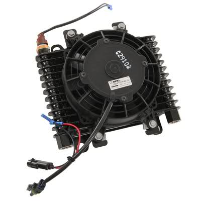

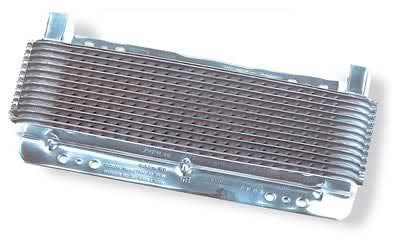

No experience with this so i dont know what size you need but I wonder if a transmission cooler from summit or jegs or somewhere would work??
B&M 70298 - B&M Hi-Tek SuperCoolers with Fans - Overview - SummitRacing.com
B&M 70265 - B&M SuperCooler Oil Coolers - Overview - SummitRacing.com

Under the hood up front inbetween the frame rails
with some venting through the hood and a fan, but does the kx have a way to make electric for it?
Maybe a charging setup off of a KDX??
Yeah ive been looking for the mojave coolers. I cant seem to find any. i dont really like egay or id get one off there. I think ill just use the ones off the dirtbike. Prolly put them right on the dg bumper and run hoses with billet inline coolers to help with heat issues. Made a bracket but wasnt sure if i liked the idea so i didnt put it on yet.
Oh sh*t yeah i didnt think of the air... Damnit. Umm.. sh*t what else can i do with the bike radiators or do i need a different one now for sure?

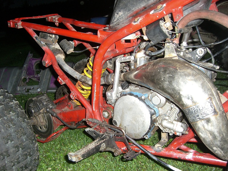

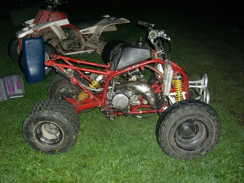

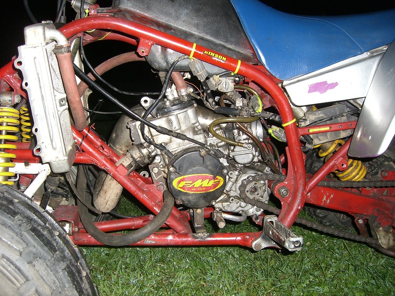

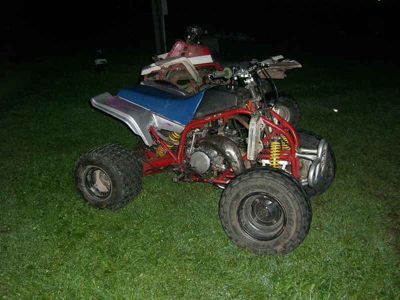

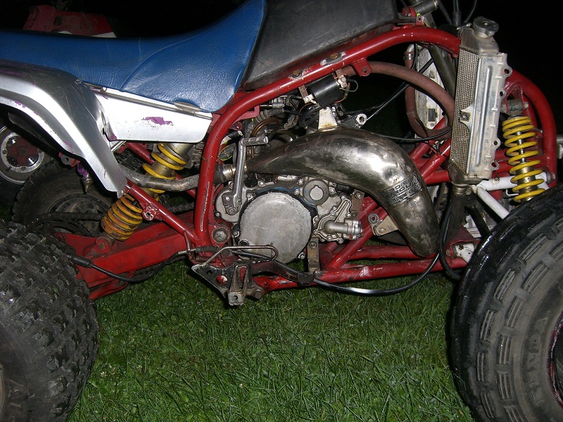

Radiators on and drove it around. Pretty pumped to get an airfilter on and get in the power band. Just babied it to make ure the chain wouldnt jump and stuff. As for pictures ill get them up as soon as i can. Looks pretty good so far and runs greats

I'm impressed too as to the time to do it !! Givving ya rep for it. What did you do for radiator? Just now had a thought, set the front on blocks so rad is higher to fill/check, also use stock fin gaurds or make something. Deffinately need pics

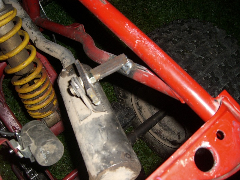

Yeah thanks had the wheeler i think 5 days and it was done. I used the bike radiatiors and filled them and filled the hole on the head with coolant and started it. Let it idle and tipped it back till i watched it gargle out the air (had the cap off to make sure it did) And it was done. Runs flawless. The pipe surprisingly fit with not customizations. The silencer was a different story but a couple pieces of flatstock and a welder and that problem was solved. Ill try takin some pictures right now and put them up.

other than the dirty motor(how it should be lol) that looks like a really good swap. One of the cleanest i've seen. Whats the ass dyno say? worth it? I bet it will run. I was always a fan of the kx bikes.
