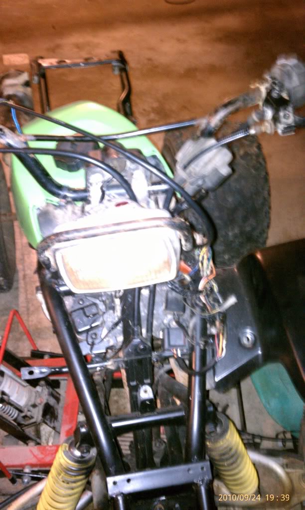

got this 88' blaster traded my 83' kdx 200 for itI:I has some problems. open for any tips or help.
list of problems....

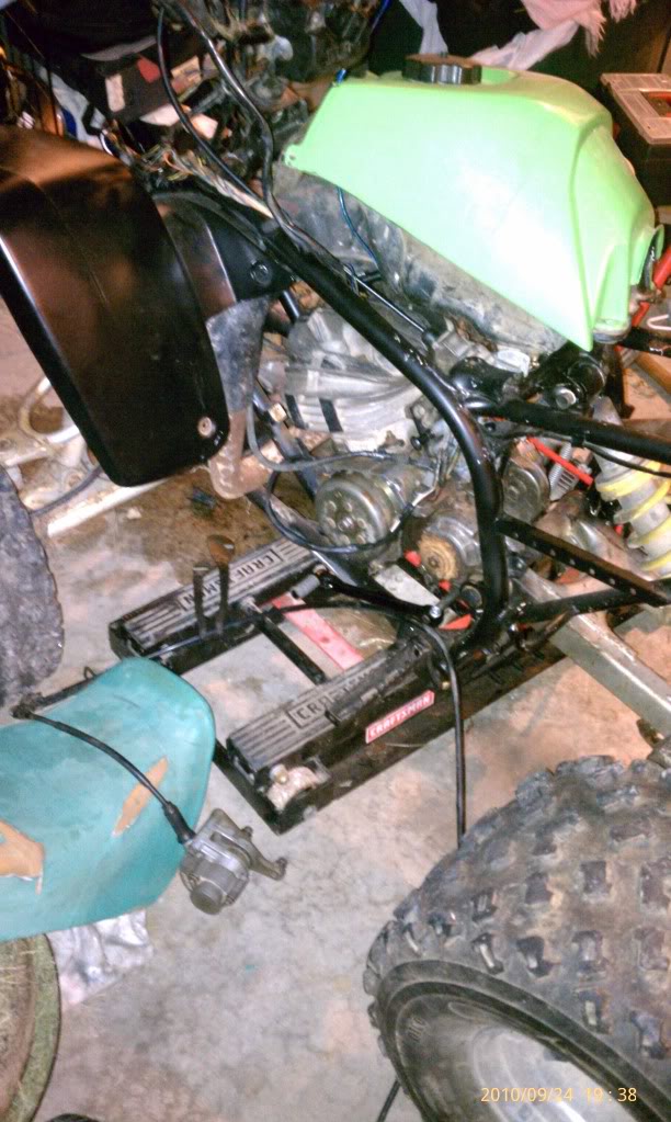

no spark

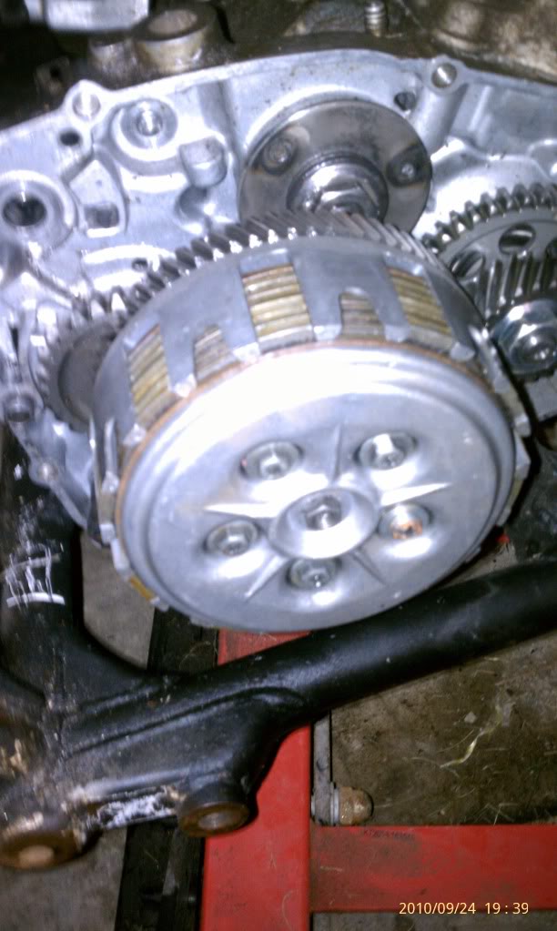

cant get it in gear(after clutch worked on):-/
clutch kinda works
frount brakes stick
back brakes dont work

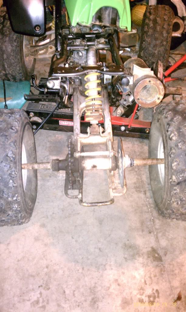

air intake does not fit on carb
list of new stuff....
cdi
stater
ext. coil
int. coils
flywheel
itp rims
fast tracker tires
possable extended axle
oil injector seal off
pro taper grips
cables
BOLTS LOTS AND LOTS OF BOLTS:o
top end
bottom end
any help would be awesome....
thanks for you time....
would not let me post pics:-/.....so idk....

No spark could be a tors problem. Try unplugging the keyswitch, tors unit on top of the carb, and the handle bar kill switch. If it's not one of those grounding out the source coil it's either the source coil or the ignition coil.
What kind of carb is it that the intake doesn't fit on it? pics!
