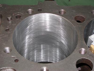

Doesn't sound like a very good builder, if you could get a pic of the cylinder up that would tell us a lot. Does it have good crosshatching, here's one ken posted, how it should be, but it is hard to see in the pic
